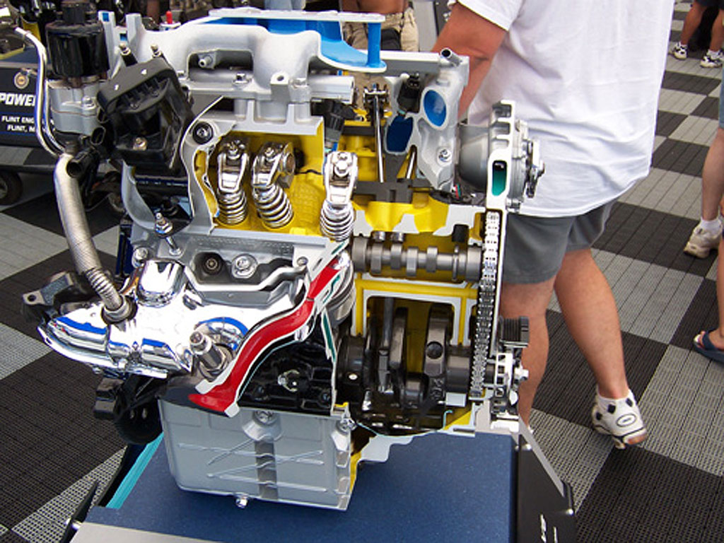

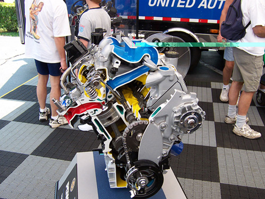

                  found this cutaway pic of a 3400.. check out that chain!
                  • #69
                    Wow that's a great pic. Are there more?

                    • #70
                      Just this one...
                      • #71
                        Thats just the old pre 00 timing chain, I bet that was a pre 2000 motor... actually, it is because you can tell by the injectors.
                        I ran that on my stock 3400 back when I built it... It has slack at 60k, how much I'm not sure since I never checked, but you can hear it slap the guide when you go back and forth with the crank.
                        • #72
                          Yikes, they cut thru the dampener too??? Jeez man!
