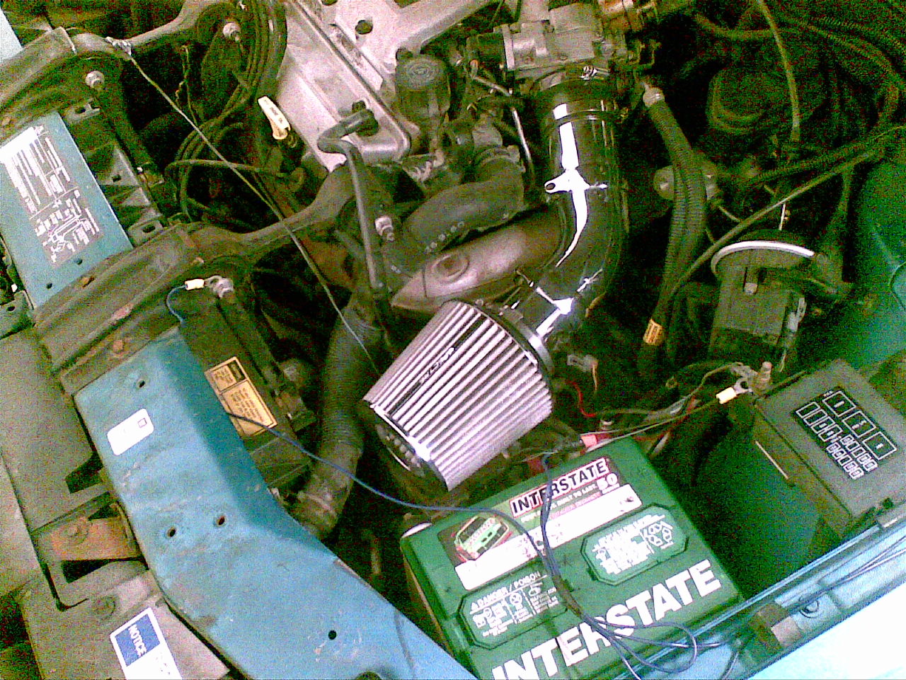

    Hello, I own a 1993 Oldsmobile Cutlass Supreme SL - 3.1 MPFI.
    Right now, I have a cone filter installed, but I would like to make it ram-air, which is the right term as far as I know...I want it to suck in more colder air from somewhere else, but I also want it to push more air in as I reach higher speeds, if possible. I did have a ghetto-rigged version of this...had a dryer hose run from the air box to the driver side fog light
    Also, would there be any hp/torque/fuel mileage gains or any reason to put a breather filter on where the black vacuum hose for the crank shaft connects?
    And lastly, the last time I took my car to the strip, my best run was 18.149 @ 76.22...I have seen posts of people with the same engine (can't recall which make/models they were) running like high 16s and low 17s stock...any idea why my times are so high?
    I can post more pics if needed. just tell me what you need to see

            Air intakes do just next to nothing for performance. I have flow benched different set-ups, and even make a simulated ram air effect device... ram air flows less due to turbulent air, (unless you can design a way that you are sure the air can flow laminarly) Basically you will not go any faster with any kind of air intake. (unless you are pulling incredible horsepower, and the box cannot physically flow enough for the engine
            cold air intake is best, ram is next, warm air is the suck... the stock air box works just fine.

              well then I guess I just want a way to get more cool air...any advice?

                        Should I do any thing else to my intake?
                        I thought maybe making a box of some sort to try to pull in air from outside the car, instead of right around the engine...not quite sure how i'd fabricate one though. maybe put breather filters where the vacuum hose hooks up to and toss the hose?
                        I'm looking for anything low-cost for even the smallest gains...or even just make it look better. Even if you just want to see what would happen if you did something, but dont want to do it yourself, tell that too, i mean, i'm not gonna hook up an electronically controlled can of starter fluid to my intake, but if anything you know might add a couple tenths of a hp or look cool, post it im running out of minor modifications

                          You could possibly try buying a cheap off the shelf cold air intake for say a honda or something, and try to modify it to work for your car?? try to get it as far away from the engine as possible.
                          And El Diablo, im perfectly aware, but even in the most efficient designs, any type of major gains are not to be had... engines will pull in air faster than just about any scoop can force feed. Its all in the physics
                          My air intake is some junk spectre one... the only reason i have it is because i had a nitrous detonation once that exploded my stock air box and blew the throttle blade off of my throttle body
                              true...My grandpa owns a hardware store, and they sell different dryer duct stuff...i dont know what its called but theres this thing that has 4 sides, and kind of narrows down to a circular connector...I'm wondering if I could somehow modify one of those to fit, thus pulling in air from away from the engine..
                              I dont really need it to force feed, but I figured that that would be a good way to get more cool air through my filter. one design I thought of was putting some kind of vent hosing (like 3") into the inside portion of the filter, and run it somewhere that would get colder air.
