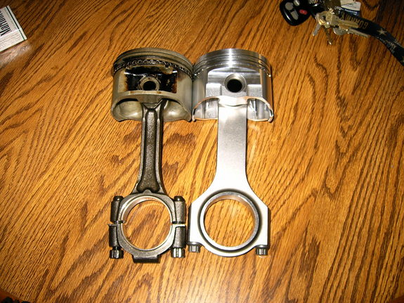

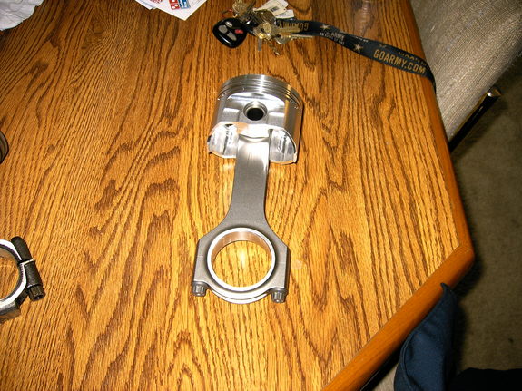

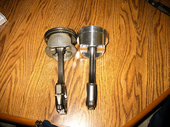

i got some eagle rods on ebay really cheap. i had the pistons bored to fit the .927 wrist pin hole. the two weigh almost the same. i still need to have the big end of the rod machined but at 15$ a rod thats pretty good..

Thats a great price....are they a 5.7" SB Rod...and are your pistons forged and where did you get the pistons?

Are those pins not floating? I would imagine pressed pins would be bad due to the oiling holes for the pins.
