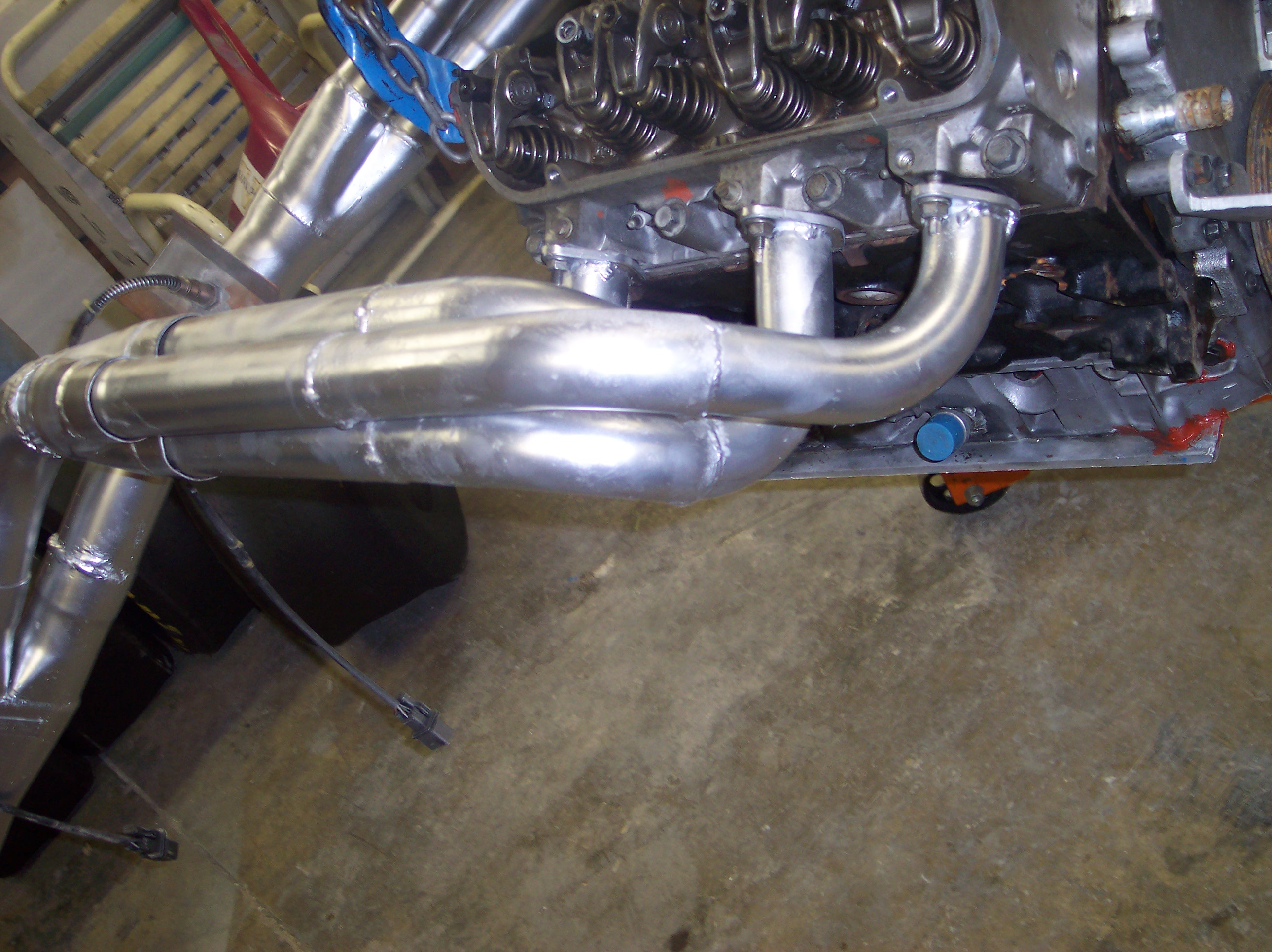

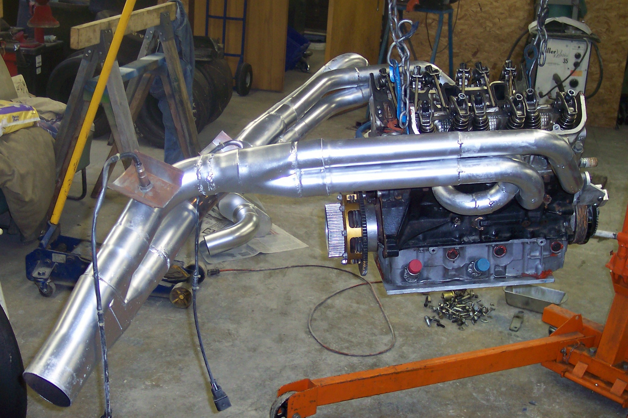

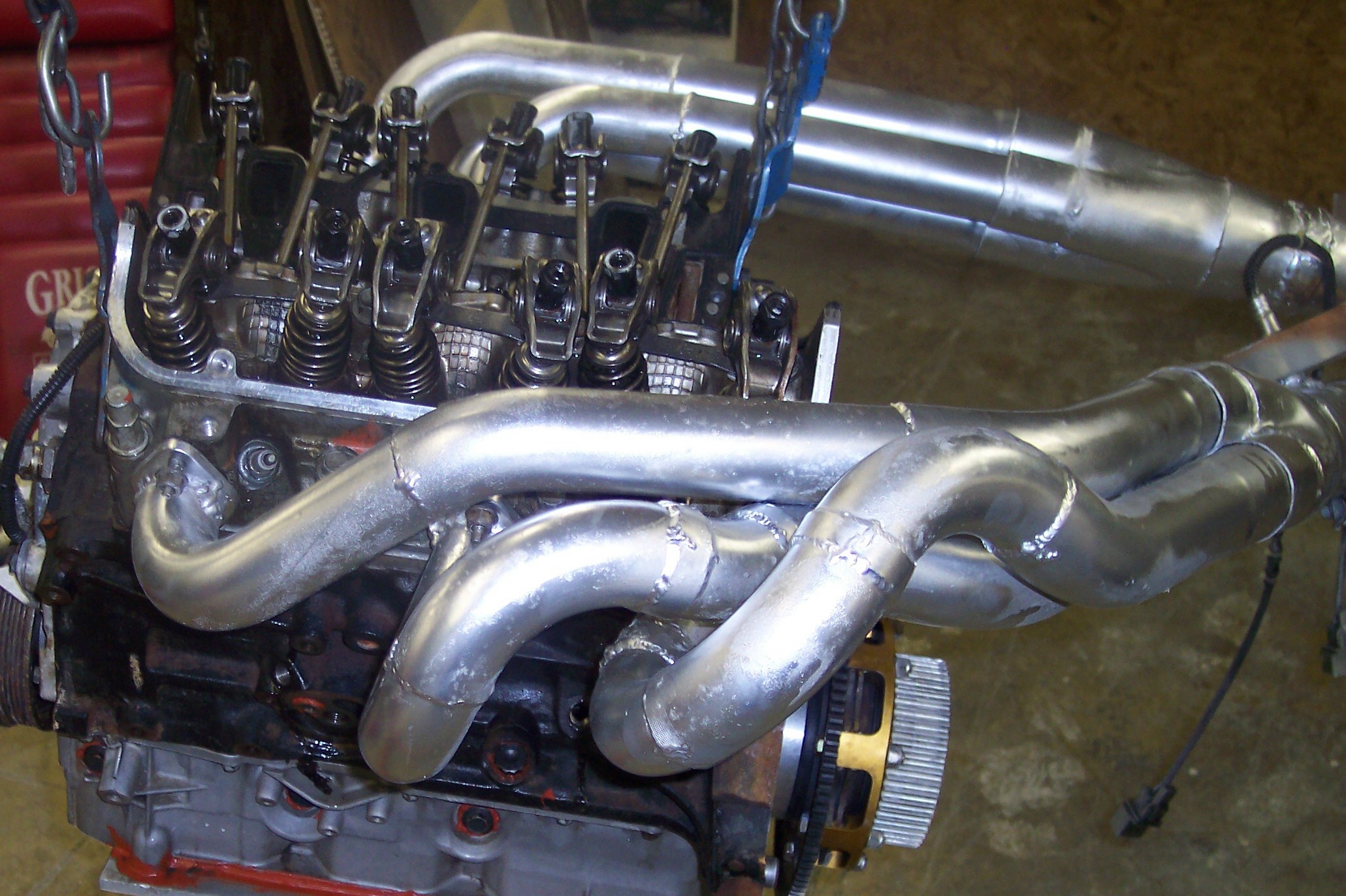

      Stepped exhaust pictures
      The easiest way to build exhausts is to build stepped tube exhausts. This type exhaust also gives more power. Three steps is common. For street two or three steps work. 1 5/8, 1 3/4, (1 7/8 ?) For racing 1 3/4, 1 7/8, 2 inch. Use .065 exhaust bends from Jegs, Summit, JC Whitney. Between them there are many types and radii. For the most part one size tube will slide over the next smaller tube. A hand tube expander from Harbor Frieght can be used if there is a fitup problem. For street you want each section to be 11 to 12 inches and for racing 9 inches net after a 1/2 to 1 inch overlap. Because these are built like an erector set, very complex shapes can be made. The overlap joints are also easier to weld. One picture shows a splice of same size tubing using the next size up. Slipon colectors from Edlebrock were used and band clamps for disassembly.
