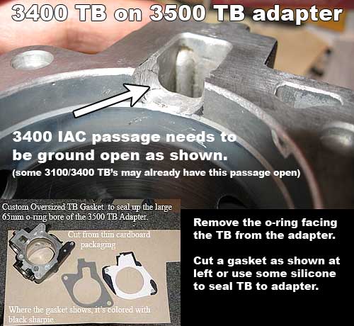

          Here is a more complete "how to" image of what's needed for a 3400 TB on the 3500 plenum adapter.
          Ben, feel free to use this on the store.
