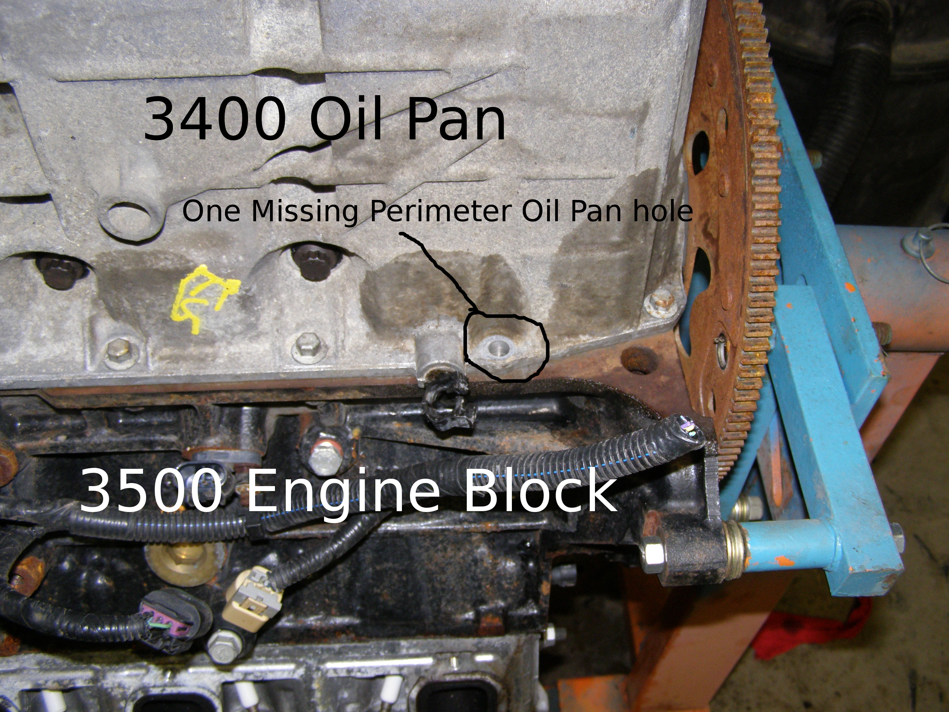

            You can not use a 3400 oil pan on a 3500 for multiple reasons, the main one being that the holes don't match up. The other being that the 3500 oil pan is clearances in several places for the connecting rods.

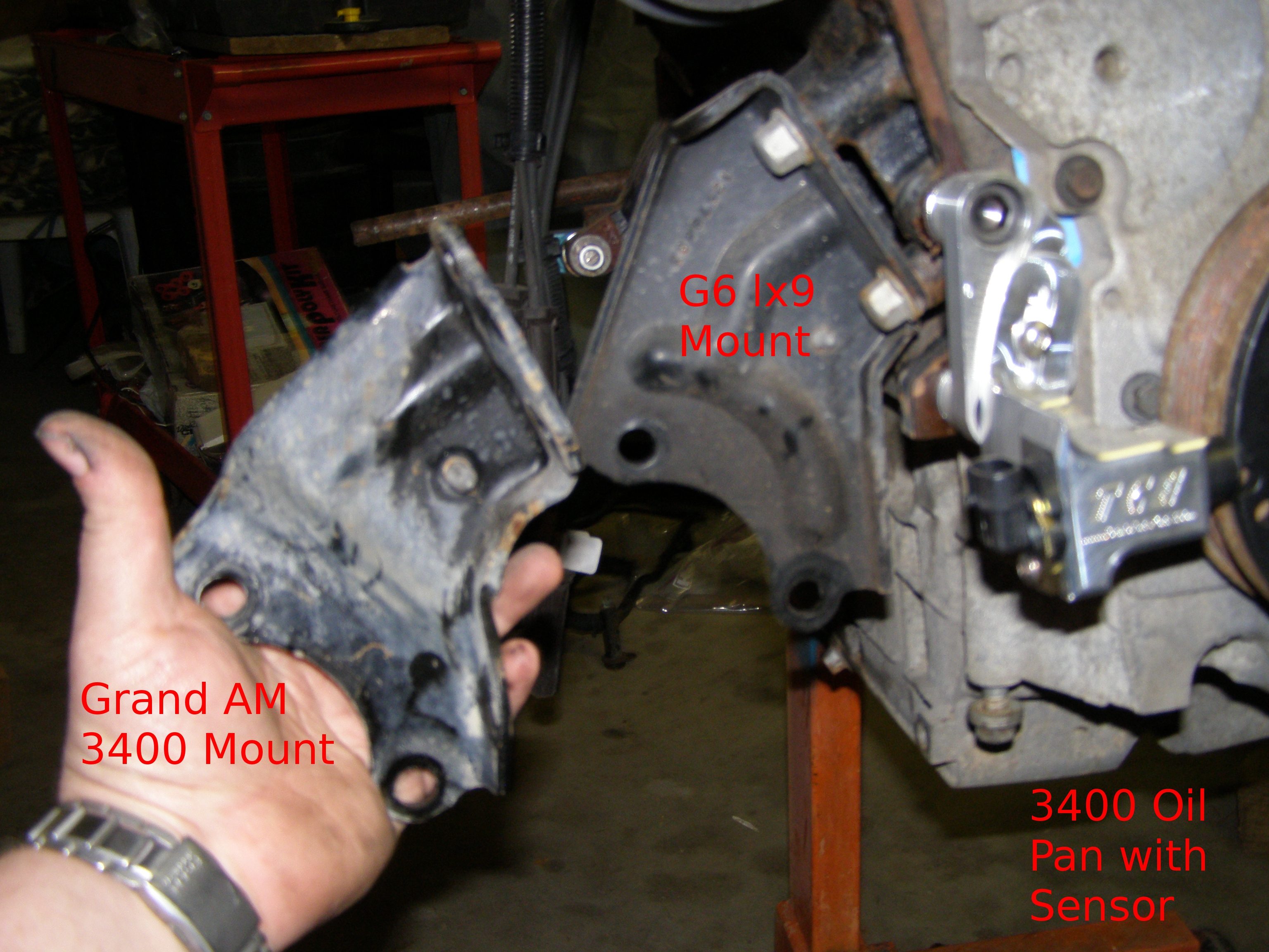

              I used a 3400 oil pan on my 3500 block. No issues with clearances at all. Ive turned the crank over by hand before putting it in the car and nothing hits. And yes 1 perimeter bolt hole is missing in the block. It could be tapped however I used the pan with 1 perimetor bolt missing. Probably not the best solutions, but I have no leaks. As for the lower engine to tranny mount. The solution is a mount that was made for the engine. As the G6 came with a 4t45e, the upper block to tranny mount is a perfect fit and the lower one from the 3400 that bolts to the oil pan lines up perfect as well. No Drilling whatsover needed.

              • Interesting. The block is notched and the pan is matched. I am surprised the stock 3500 connecting rods clear without the pan clearance.
                  Have you started it yet? Once the engine gets going, things are going to start to stretch, and that's where you might run into issues. GM clearanced the block and pan for a reason...
                  • yeah I've drove it 4 different days and until hot so I could bleed the air out of the coolant system.
                    • Well, good luck with it! Hopefully it works for a long time without incident!
                      • He isn't the first that I have heard, that has used the 3400 pan on the 3500.
                        Personally, I am sticking with the 3500 pan.

                          I'm glad to see you have a mount that works. That 4t45e mount that bolts to the engine perfectly, anyone know if the other half would bolt to a 4T60E?
