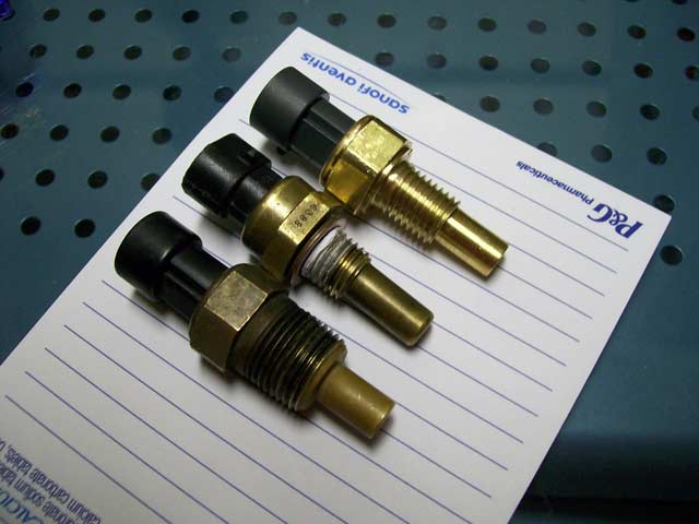

      • You can only turn it down a little... too far and yes then you cut into where its bored out for the sensor wires. Notice how in my pic the thread length is very short in comparison to a stock one. Use the thread count for reference as far as how far back I turned it. There is only about 4 threads on there IIRC... After that was done he just trimmed off the old threads to make it look neat.

            Here is mine...
            Machined sensor on top (machined all of the stock threads down, didn't hit any wires?)
            Stock 3500 sensor in the middle
            Stock 3 wire sensor on the bottom.

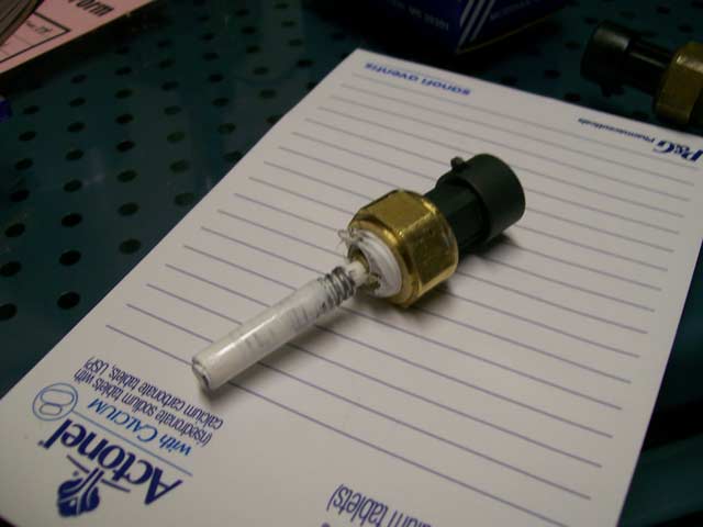

            • I really do have the worse luck...
              GUESS WHERE THE OTHER HALF IS!
              How in the HELL am I going to fix this now?!? Either I SOMEHOW get all of the threads out (which are fairly flush with the head btw), or I JBWeld this SOB on there and hope I never have to replace it (it is brand new).
              I should have just waited for the fucking adapter...

              • LOL sorry. Can you get anything in there to pinch and untwist it? damn. Must be screwed hard in there too.
                • Use an easy out, there is already a hole in the middle of it for the sensor.

                  • mine just broke on the lathe, not because they were threadding it all the way.. they only had about 1/4" or so cut down...
                    I had a stock LS1 sensor break off in the head when i was assembling the engine, i freaked for like 5 minutes.. then just used a small flat head screwdriver to turn it out.. came out easier than it went in.

                      But wouldn't an easy out just end up breaking the rest of the brass off inside the engine? Unless there is an easyout made to go onto a screwdriver, there is no way I am getting a drill in there. Remember, I am in an engine bay putting my hands around a header crossover. I saw your warning, but after it was already done.
                      It isn't screwed in hard, as soon as the base of the sensor touched the head it fell apart. I knew not to torque it hard, but it was barely any torque at all.
                      Superdave how did you use a screwdriver?
                      I feel like I'm going to puke
                      There HAS to be a way to get this out without pulling the engine to get to the head.

                        Like Superdave said, a flat tip screw driver should take it out, make sure you use one in like new condition with square edges that can bite down into the brass, you should be able to tap it in a little to make grip marks in the sensor tube. If you can find one use a screw driver that is not much larger than the hole so that you have a larger contact area with the screw driver. I had to do this once to remove the threaded area of an IAC motor that I broke off in a throttle body.
                        • You can use an easy out with a tap handle or adjustable wrench too, you don't need a drill.
