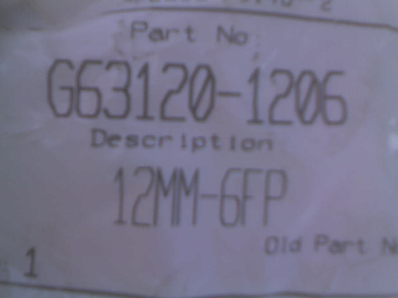

    Where did you order the adapter from? Does it look like coolant will be able to flow around the sensor at all? Will the sensor "probe rod" part that sticks out even fit into the adapter?
    Don't know for sure, but i assume coolant will flow in and out decent enough for a good read.
    I bought it at a local Car-quest auto parts store. The guy at the counter was really surprised that they even carried that kind of adaptor lol.
    update with pics. adaptor cost 13$
