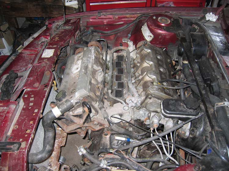

                  I'll post up some pics later on of a 3.4 DOHC in a 2nd gen. I have to get permission first though...
                  It really dosen't fit very well.

                    You have to get permission? Chris has already posted pictures on here before, in the swap area. Do a search and I'm sure it will come up.
                    • #25
                      Didn't know that.. i found them after browsing his 3500 pictures.. haha
