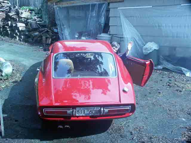

    I machined off the GM stuff on the upper plenum and had the MG placed there - it has already confused some people. The base car is a 1957 MGA, BTW.
    MG? GM? Hahah kind of goes together. Nice clean setup! I like it! Looks great. That's a big radiator! Did you have to bore out the intake manifold for the 62mm TB?

      The radiator is an alloy crossflow racing rad from Afco - weighs 8 pounds, and has welded seems (none of the clamped garbage that comes apart on you).
      I forgive you for asking if I bored the intake throat. Yes, I've been building race cars for 30 years and I did bore it to match - in fact because of uneven casting it broke through in one place and that's why I painted the whole upper plenum instead of polishing it, which would have shown the Devcon patch....:-) I understand why you ask, though as I have also seen people that buy stuff and just stick it on without any thought to matching everything. The lower intake is matched to the heads as are the exhaust manifolds. Because it isn't a race engine I decided not to bother pinning the manifolds to the heads.
      Transmission is a T-5 out of a V8 Camaro (better ratios than the really low V-6 trans had), and a 3.9 diff ratio which means excellent acceleration.
      Exhaust is single 2.5" into a Magnaflow straight through muffler and a Pacesetter splitter/resonator. Sounds really good, but then I am prejudiced!
