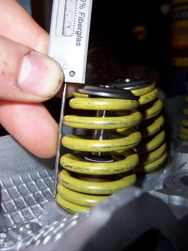

    didn't measure them yet, I'll check them later, I'm also going to remeasure spring height to be sure its 1.8 so i'm getting the right spring seat pressure.
    I didnt think the 2.2 seals worked for the 03+ heads but maybe I miss read it somewhere.
    either way these work great, and they press on nicely so I'm not worried at all about them coming off.
    spring height is like 1.3 iirc...
    i have the same springs on the same heads. machine shop said coil bind was at .560 with safe lift at .500.
    • #17
      I hope to hell your spring height isnt 1.3... I think they ment to tell you that it binds at 1.3, Installed on these heads with those shims its around 1.880 Rough estimate with a cheap measuring tool... Definately not the right tool to check it correctly but it gave me a rough estimate.
      Which would mean with installed height of 1.880 or 1.9, and .500 lif that puts you right at 1.38, or 1.4, depending on where you start, so ~1.3 bind sounds right.
      • #18
        With 1.880 or 1.9 installed height I gotta be sure to check spring seat pressure... It may be lower than I want.
