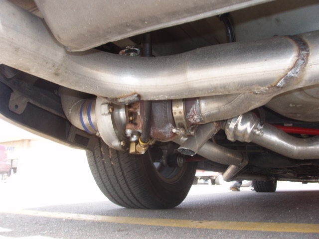

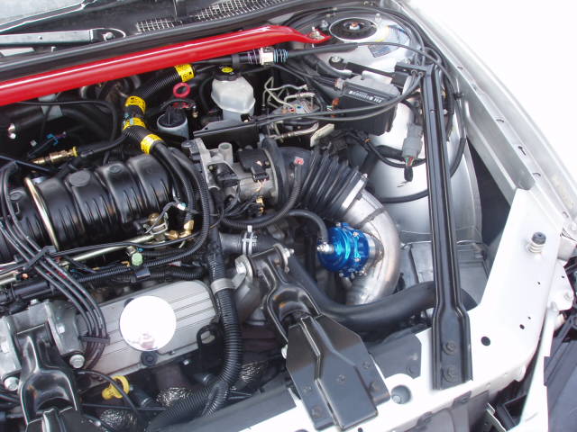

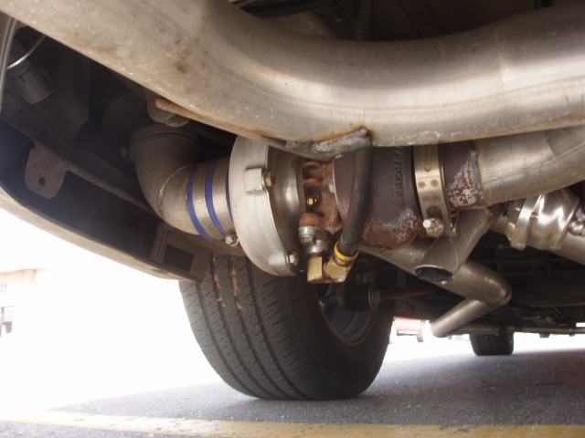

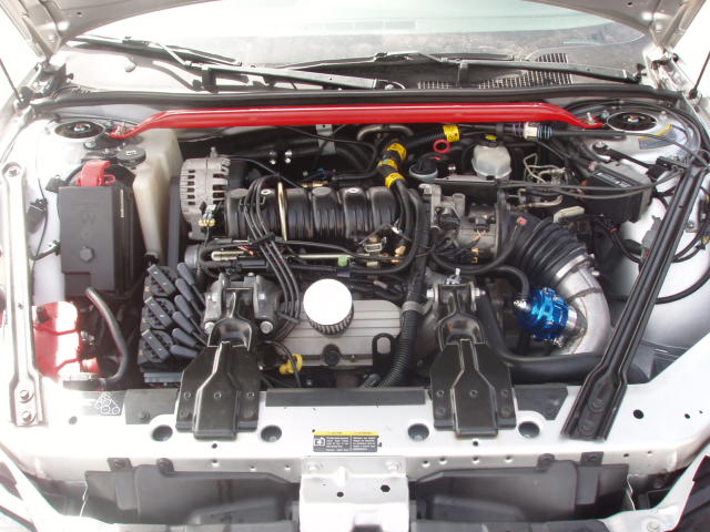

            sweet setups for sure...i got some pics on a gp here locally with the sts kit if you are interested.......
              yah i wanna see em, what year model?
                coming right up........i think it was an 01
                  two more........they also have a gtp that is twin charged with the sts but i'm not sure what i did with those pics..........
                    are they not using the oil cap return line? if not where are they putting the oil back in at?
                      so the smaller pipe running up the drivers side is the intake piping? does it have an intercooler also?
                        not sure exactly obviously t'd in elsewhere
                          thats how mine is gonna b also, but with an I/C also
                            i rode for quite awhile in it and even without an intercooler the temps stayed down pretty far, about equal to what i used to pull on my roots/w2a setup.....
                              sts claims that the pipe running from back to front works as about a 50% efficient intercooler, and claim less that 0.5psi pressure drop, were a normal intercooler is 1.5-2psi. an intercooler actualy isnt needed.
