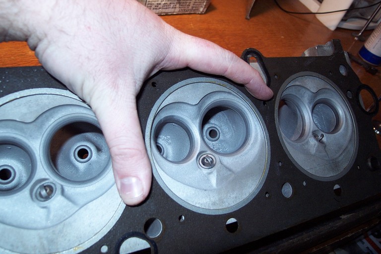

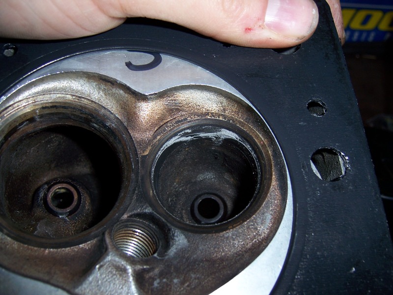

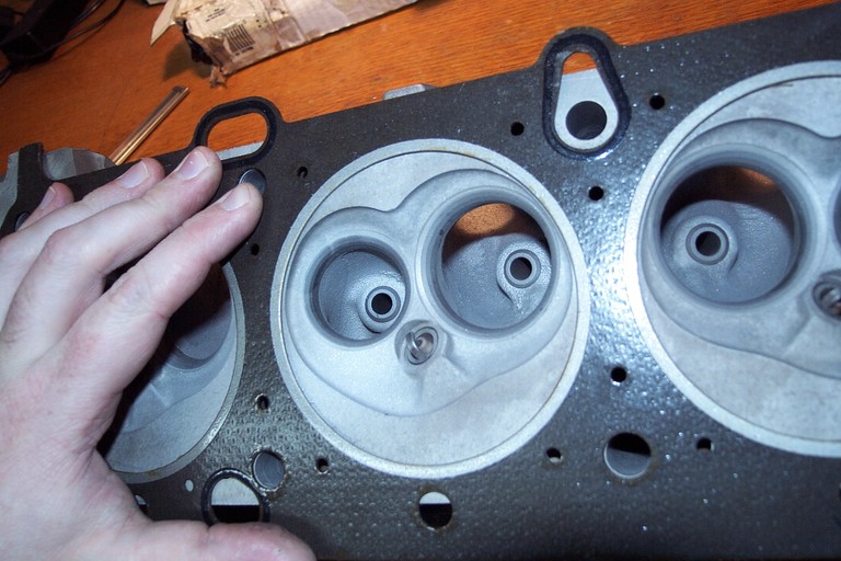

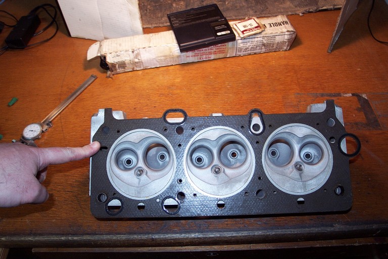

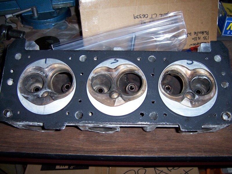

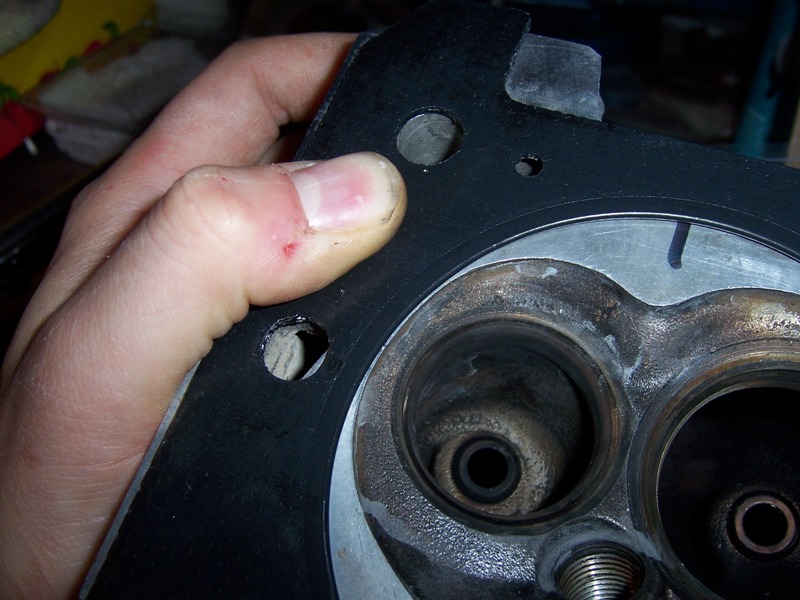

    I found a 3100 gasket and took some pictures of it on the 3500 head.
    The fire ring overlaps the combustion chamber on the intake and exhaust areas. Not much, certainly not the width of the fire ring but I don't think this is a good way to be. I am not sure what will happen if you use a 3400 gasket on a bored over 3100.
    I used some clay to form around it and its .025" overlapped.

      I want to see a 3400 gasket on the 3500 heads.
        I have a 3.4 DOHC gasket, which is the same thing as far as bolt pattern and bore goes.

                Correct. 3400 top end is the limit for a stock 3100/3.1/2.8. Going .060 over might fix the problem and using 3400 gaskets. Im not entirely sure on that though.
                  Find out!

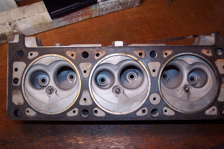

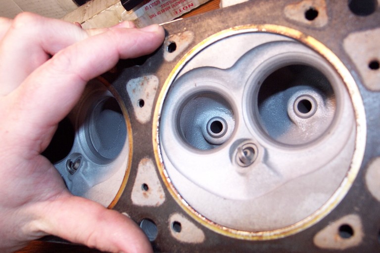

                    Pic of a 3500 head with a 05 3400 gasket...

                            Bringing this back from the dead out of curiousity, what issues would you run into if you used a 3400 head gasket on a 3.1/3100 block w/3500 heads?
                              The chamber will still overlap the deck.
                              EDIT: It also appears the valves would be shrouded by the cyl wall.
