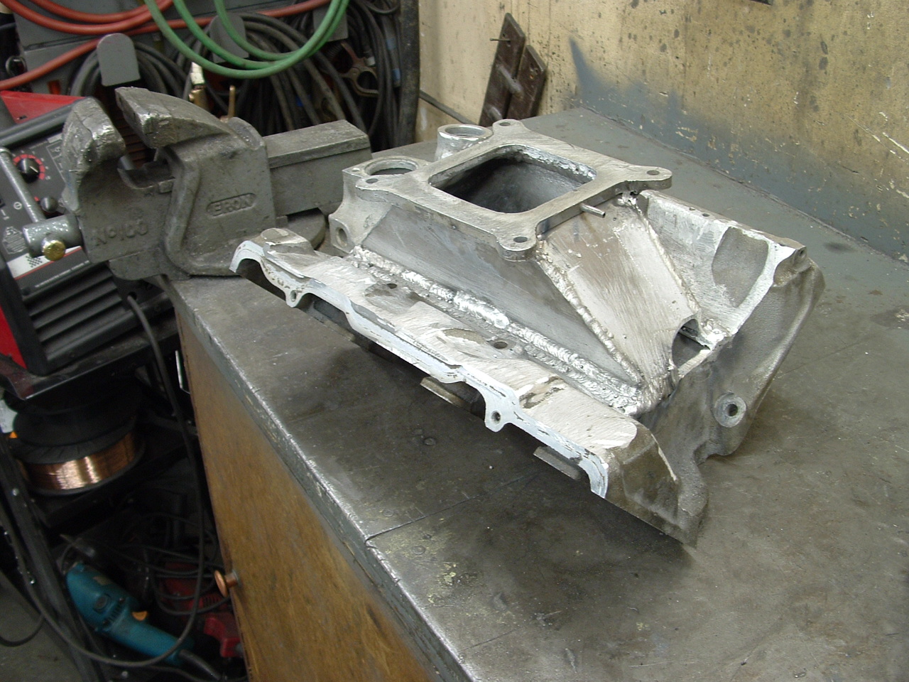

        and heres some shots of the new engine im building
          as u can see i was able to get the gen2 manifold to clear the distributor,but i decided to go ahead and start machining away the runners of the manifold so i could build a complete custom manifold for my needs

              well in some of the pics u can see were i stared making plates/flanges that bolted to the heads,i was gonna make a sheet metal manifold out of those,but then i found the 3.1 lim from a berreta that would almost fit the distributor.after machining the back of the manifold for the dizzy to fit,i decided i didnt liek the runners in the manifold so i just started machinng them away,when im done alls that will basically be left will be the holes for the injectors with the whole middle of the manifold gone,leaving me to make my own runners and plenum.
              pretty much the same thing i was gonna do with the plates but atleats now the sides the bolt to the heads and the end rails/water pasaages will all be intact in one piece,saving me alot of work down the road.
              other then that its hard to explain but as i work on it ill keep posting pictures so u can see what im doing

                      crazy manifold, id like to hear how it welds once ur done, make sure to presure check it, that aluminum is shitty to weld to, but im happy someone else is choppin a 3.1 manifold, mabye one day they will make an aftermarket one..

                          could you show more picture of the LIM and the distributor. I want to do the AL head swap too but just wanted to know what has to be done to run the dizzy. I plan on a custom intake but didn't realize the lower intake stopped to use of the dizzy. I knew the upper was problem.

                            here is one way, I just noched that out then welded a peice in and the distributior fits and moves enought to time it..
