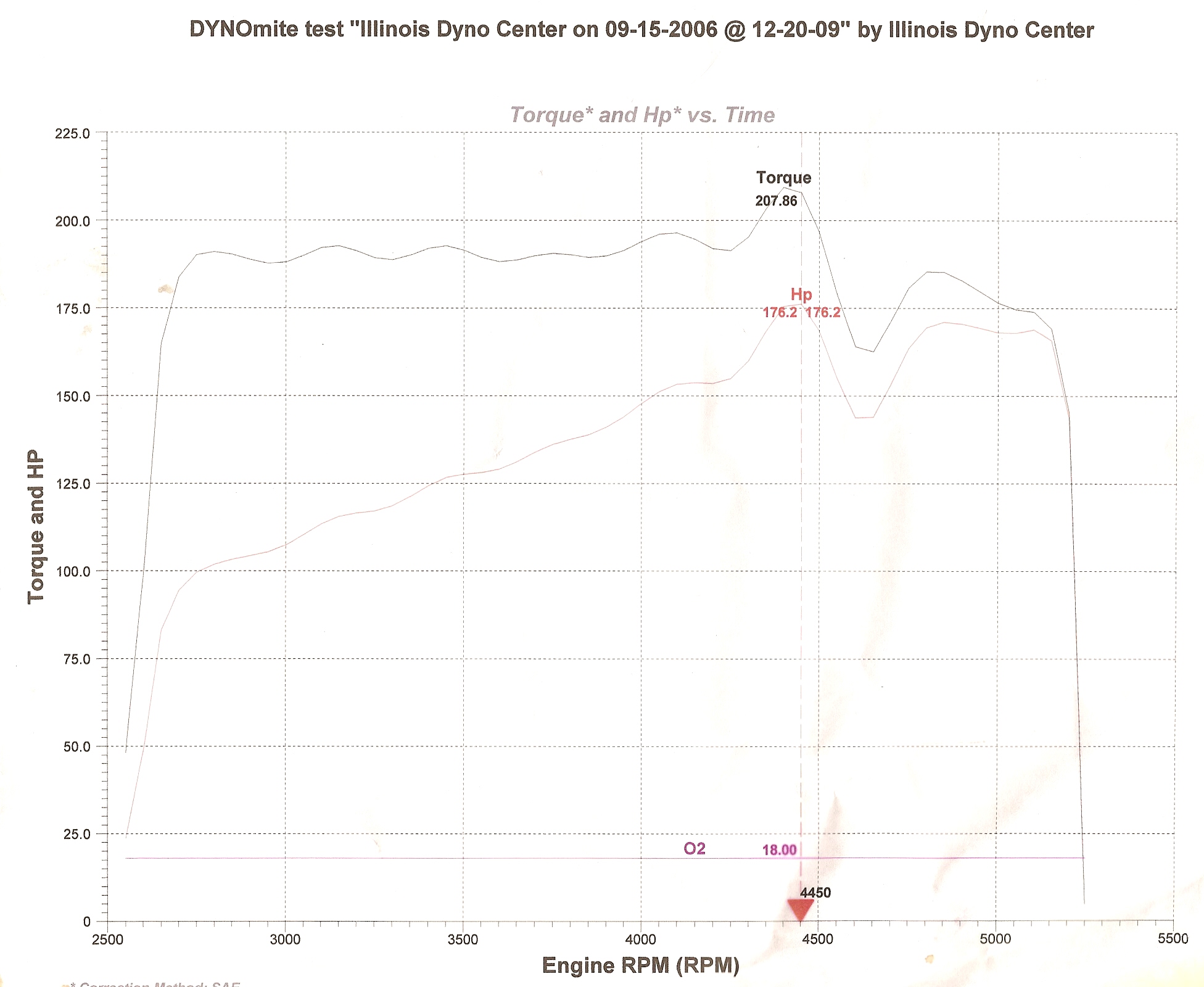

These are simulated results from dynomation with pro tools. First are the stock 3400 numbers, then the stock 3400 with stock 3500 top end swap. Last is the 3500 top end swap with my ported manifolds. 56mm TB for 3400, 65mm for 3500 top end swap. 3400 exhaust manifolds were used for all exhaust flow numbers. Ill post up the specs of the stock 3400 so you can see all the information it spits out.

I will post the 65mm TB simulation on a stock 3400 as well.
