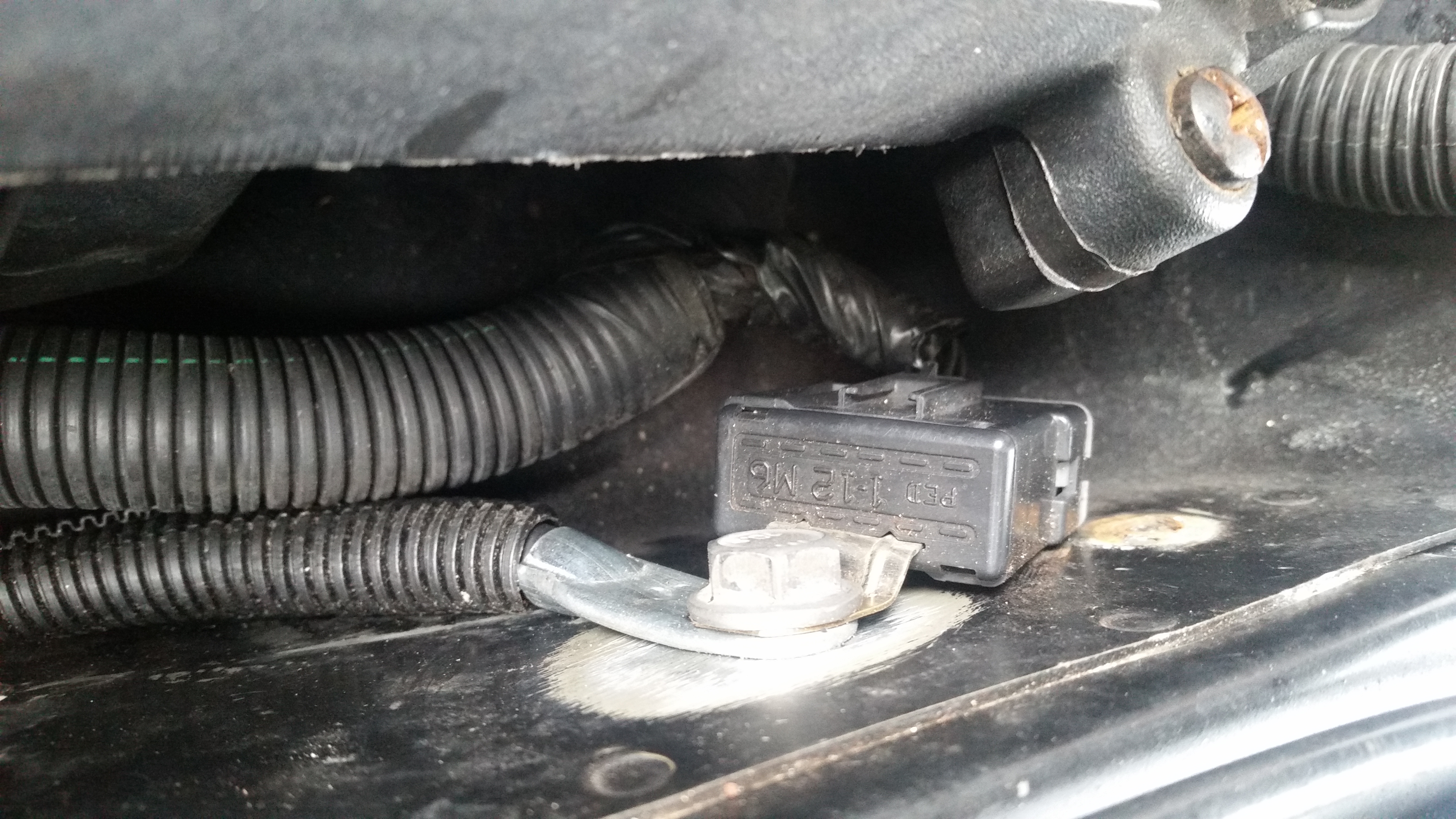

          I called it a module but it's really just a ground junction. It's located on the tranny stud right behind the shift cable bracket where the cable connects to the trans linkage. You can't really see it unless you remove the bottom part of the air intake filter housing cause it's hidden under the exhaust manifold pipe that runs along the side of the engine there. It's a little black plastic square thing with a bunch of wires coming out of it, and on top of it there's a metal ring that mounts to the stud and provides ground for all those wires.

              No problem. If it helps, here's another one that was mounted up on top next to the air filter where I could easily get a picture of it.

                That does help! I have to find it on my car(no time yet) and the GF's car(it's the one having problems).
