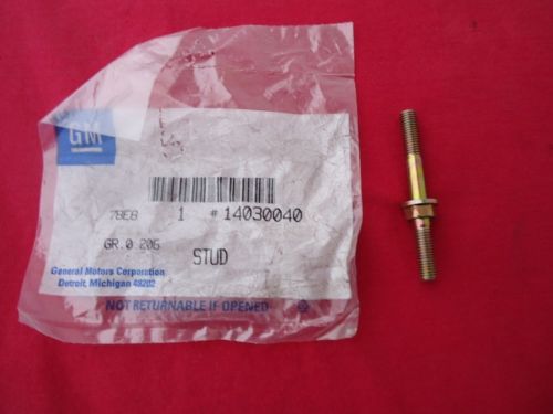

    Having a hard time finding a replacement bolt/stud for my water pump. Its the 8Mx1.25 stud with a bolt head in the middle. Its about 45mm stud on one end and about 25mm on the other side.
    I call it a bolt/stud for lack of a better description. Any one know were I can find a replacement?

        Found a replacement, GM part# is 14030040, its installed and fits perfect.
