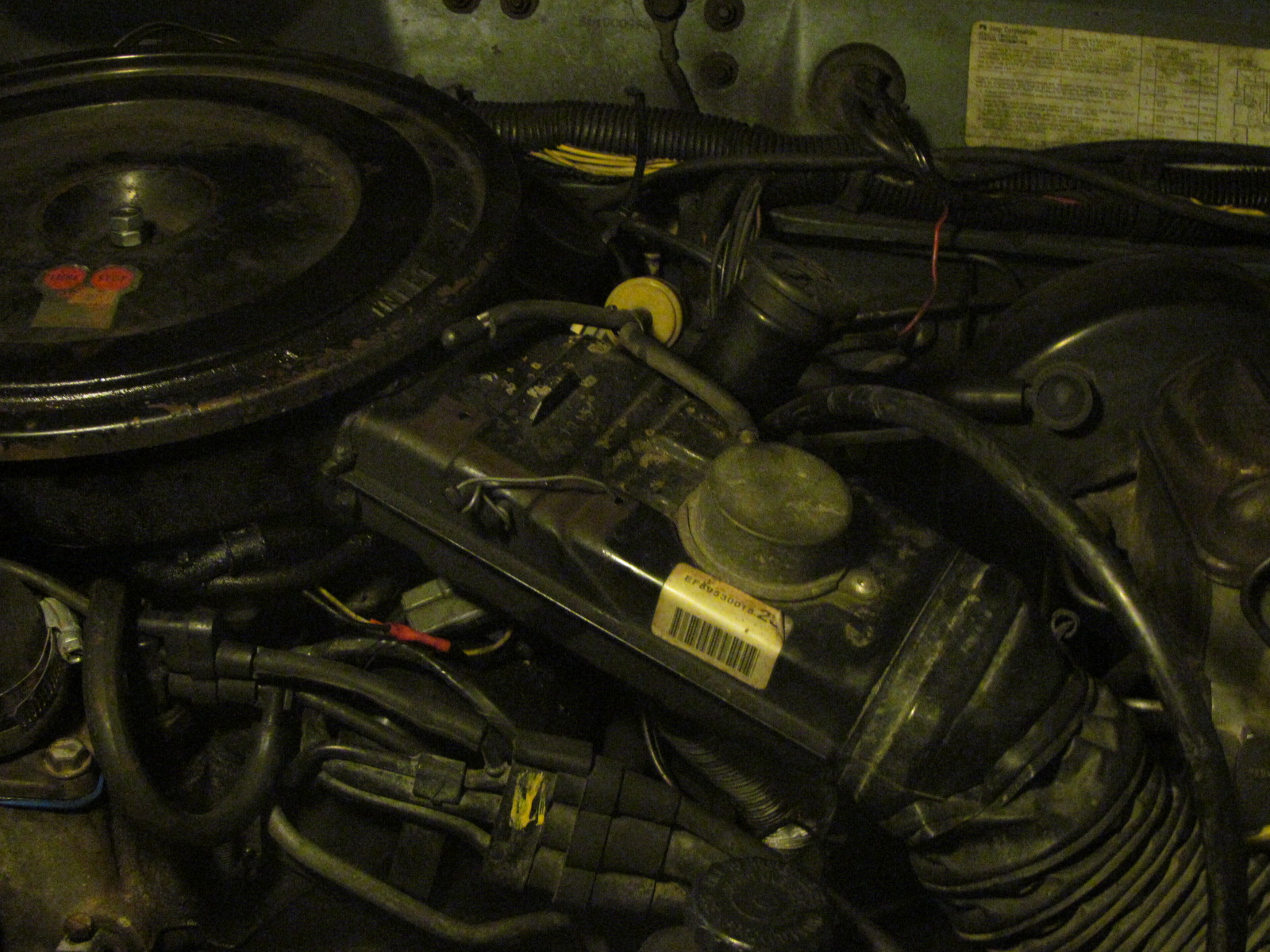

    I have a 1985 jeep with the original Cali emmissions set up. It has the e2se and miles of wires and vacuum hoses. I need a little help finding a replacement vacuum actuated motor for the trap door on the air horn. I have tried all of the normal parts stores and nothing it is the second vacuum motor on top of the air horn. The first one opens the EGR and the second one controls a door that opens a door that controls air flow into the carb. I figured having this would give me great mpg.
    Maybe this pic will help. some guy in Cali has to know something.Click image for larger version

            AH.. no the motor for the EGR is fine and in place. I have an additional motor that sits behind that. It controls an airflow door that opens and closes for the total amount of air going onto the airfilter through the horn. If you look closely there is a vacuum line plugged off and a discolered patch. I have seen a system with an air door in new cars but it is electric operated and and gives about 1/5 better hwy gas when fixed on new models from experience. This is a Cali emmisions jeep none of the local 2.8l in the j/y seem to have this I'm in NC.
              That photo is very dark and it's hard to see what's there. Can you use a flash?
              I see an arm that is held open with a wire.

                I will take some better pictures tomorrow. that wire is holding the extra door open. It is suposed to move back and forth with engine demand or something.

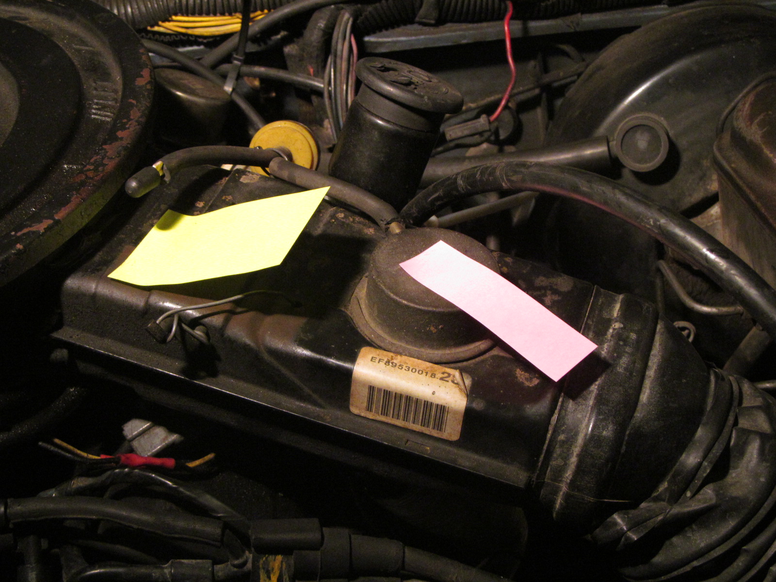

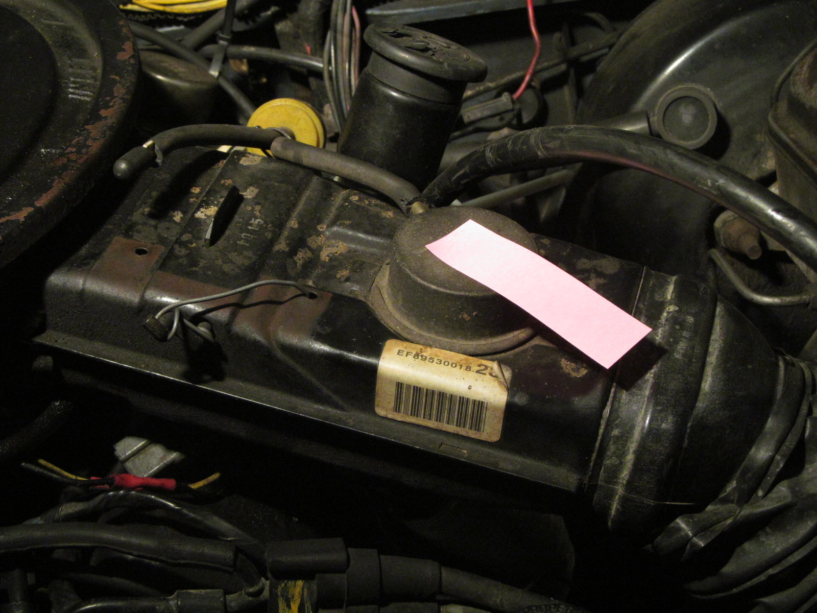

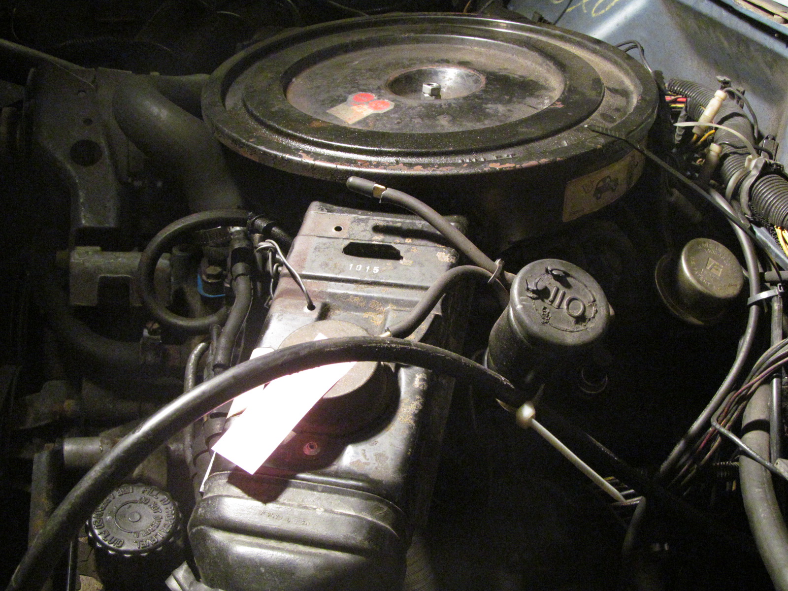

                        better pics,the one one the right is for EGR. The left is the missing part in question.
