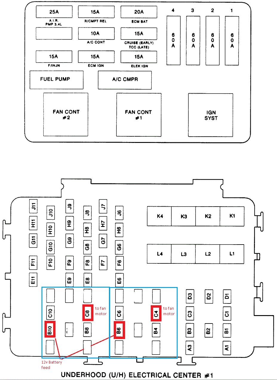

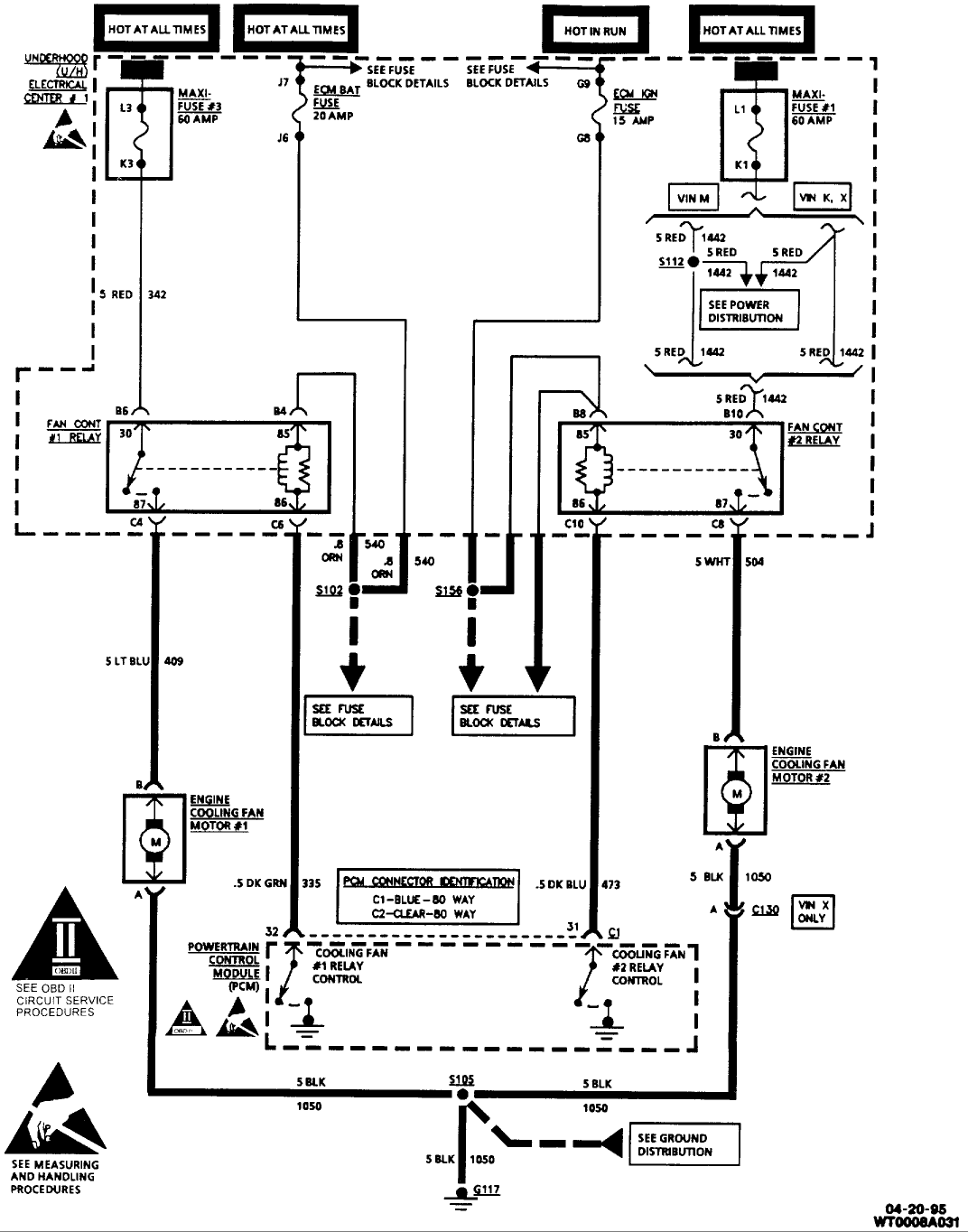

              Here are diagrams to help. They are for my 96GPse but they should be similar if not identical to yours.
              At this point it seems like the fans are not turning on when they should. I think this is the root of the over heating issue.
              You can try jumping the relay pins marked in red, carefully not to shock yourself. If that doesn't turn the fans on, check the extra large maxi fuses, #3 specifically on my car. Or check and see if you get any resistence between the fan pin and the engine ground (frame/bolt/batt neg). the motor will have some resistence to ground, if you get any it is most likely not a broken circuit there.
              If they do turn on, then the PCM isn't triggering them to turn on.
              The PCM grounds the connection and if that fuse which powers the relay was blown, your car wouldn't run, it powers the PCM as well.

                Alright, I will try that as well.
