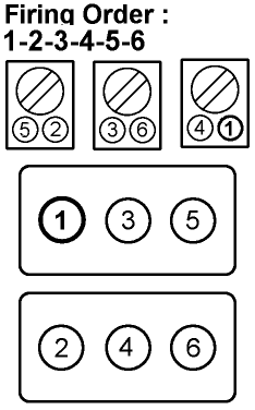

          ^ Correct? Which 3100 am i working on lg8? Firing Order 1-2-3-4-5-6?
          how would the cylinder numbers wire to the coil pack? Like 2 doesnt go to 2 on the pack and 3 doesnt go to 3 on the pack so how does it go? i need to get this figured out ASAP as this is the only transportation we have at the moment, call me retarded if youd like XD

            Yes you have LG8 engine.
            3.1 liter V-6 VIN "J"

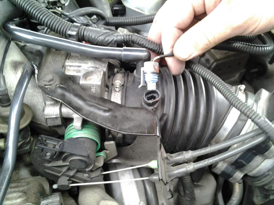

                      What is this i unplugged, didnt make a difference in revving, JW

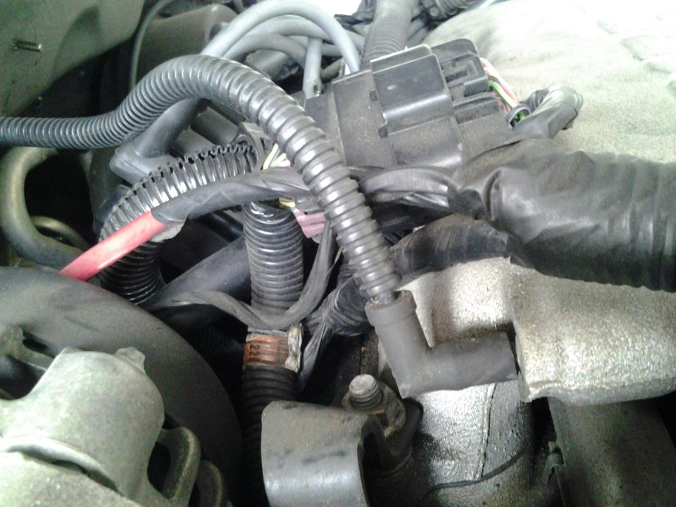

                      What is this plastic hose that runs along the main harness into the cabin? the L shaped connector is falling apart

                        Worth testing the fuel pressure, especially when running lean. Fuel pumps can weaken and provide low pressure, the pcm makes up the difference by increasing the IPW when the O2 sensor reads a lean burn. Though it wont adjust when cold, open loop.
                        Top pic is the intake air temp sensor
                        Bottom pic is the vacuum line to the heater/ac vent control box thing. If that is leaking air into the intake, you are feeding the engine unmetered air. That is a vacuum leak for sure.
                        The "T" leads to a vacuum reserve sphere tucked under the driver wheel area (at least thats where mine is). It has a check valve so there is vacuum available for the heater vent controls at open throttle.
                        Make that air tight and check the rest. It is very important no air enters the intake other then through the MAF onto the throttle body. But you probably know that.
                        Hope that helps
                        EDIT: In fact, if you really do have a vac leak there, I'm willing to bet sealing that will resolve all the engine issues, just like that. A friend of mine had a terrible idle and other issues with just a crack leaking air. If you cut the line and seal it, you will just loose all vents except for the windshield defrost. But it wont effect engine operation so long as it is sealed to the manifold.
