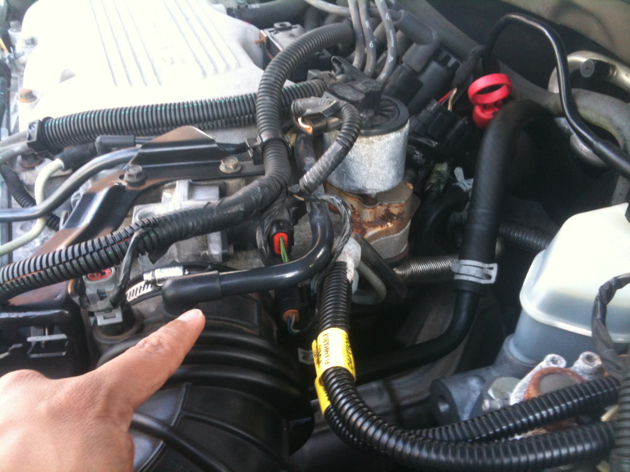

              The breather tube that starts in front of the TB next to the air temp sensor and runs to the back cover leaks on cold start but seals up again when it was warm. The rubber grommet on that piece went bad for mine. No auto store caries it or could find it so I went digging in the Pull-A-Part for one that was in good shape. 3100(non LG and 3400 had a slightly different bend cause of the newer air box and zip tube. I ended up getting both for the top swap later on. Will take a pic side by side one of these days.
