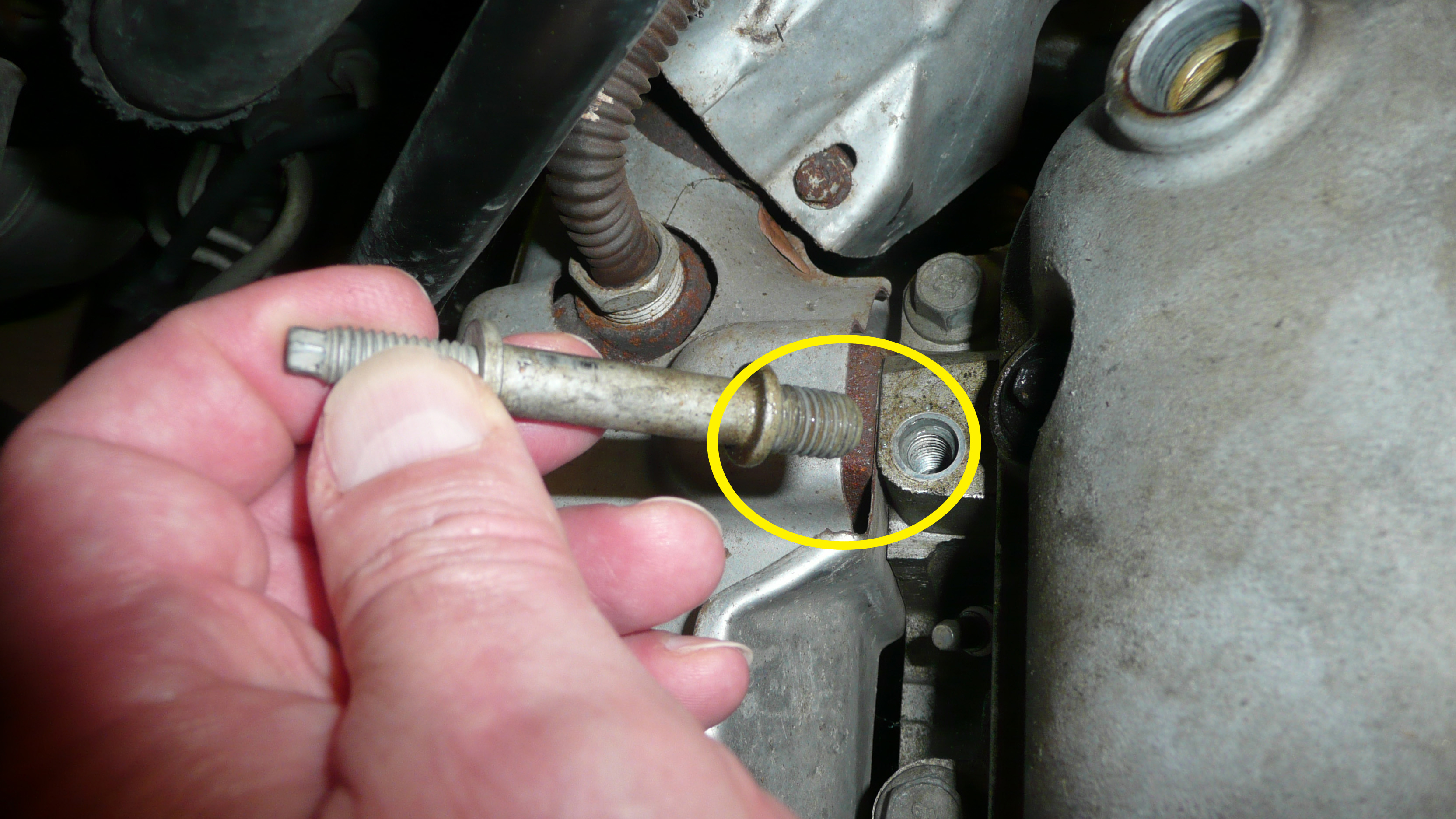

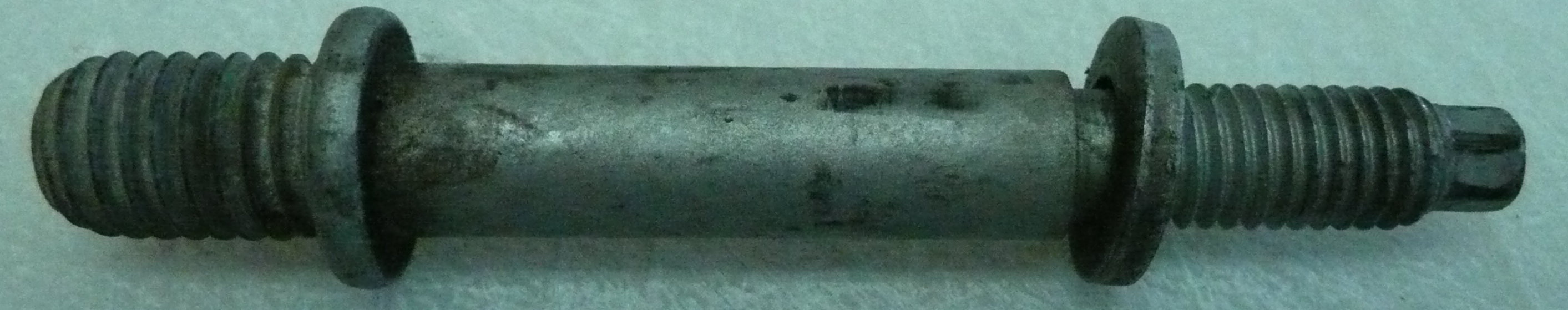

Sorry I didn't get back sooner. I have uploaded 2 attachments. The first shows the ignition coil assembly with a bolt at the top and a nut at the bottom. The second attachment is what I'm trying to find the torque specification for; the stud post bottom screws into the head and the nut fastens a corner of the ICA to the top of the post. I looked through the torque specification information (really a godsend compared to Chiltons or Haynes), but couldn't find that particular spec. Would it also be 18 ft-lbs? As I said, I'm a little leery about over-tightening the post on the aluminum head.
Yes, still the same. If you look at the LG8 3100 specs instead of the L82 3100 specs, it lists it slightly differently:
Ignition Coil Bracket Bolt/Nut/Stud : 25 N·m / 18 lb ft-Brad-
Not to dig up a semi old thread, but even though a 5.5mm socket can work, the correct socket is an E8 inverted torx.
