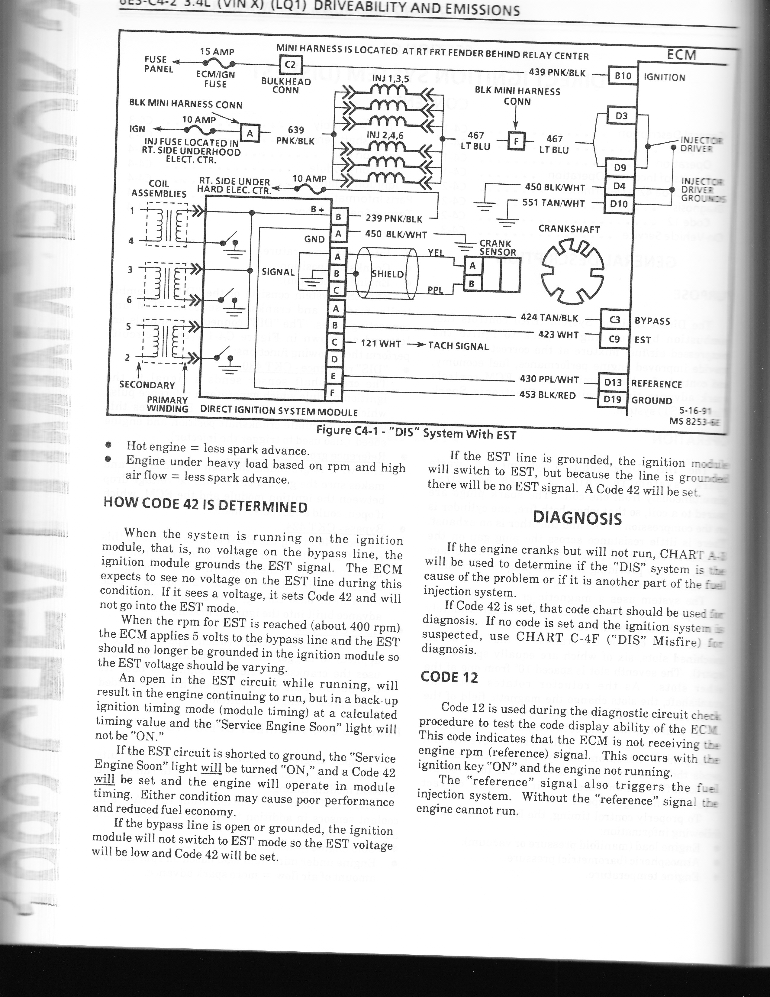

      well I replaced the parts with part I had from my others engines that were known to work LOL. I will look into what you say, but pocket do you have ,by any luck, a wiring diagram from a ignition module? that would help me out. thanks for the help.
      Mike 60degree addict.
        This is a DOHC, but should be the same (not sure how I get them scanned in sideways when they look straight on the platen...). Hope this helps
