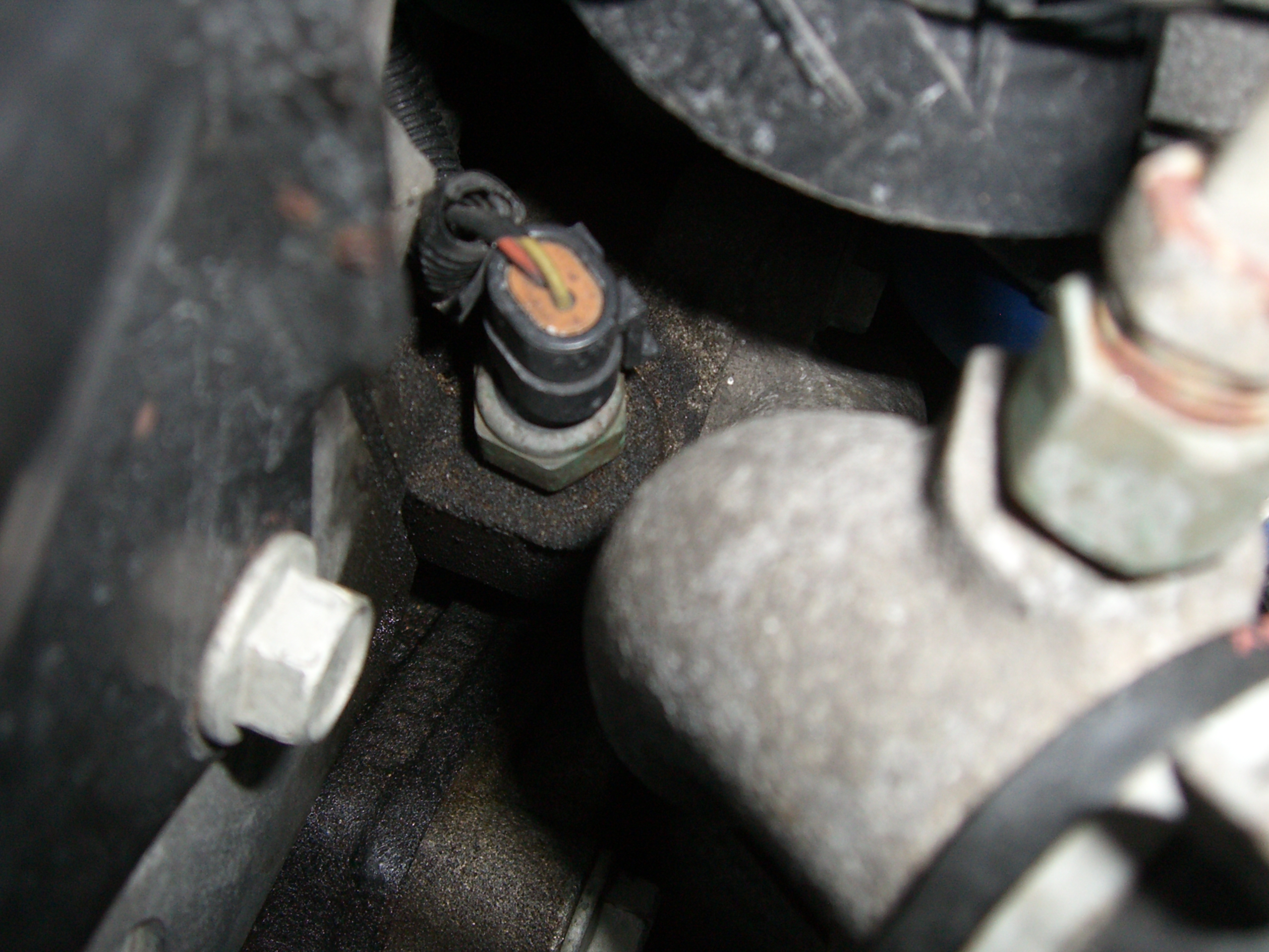

    I have a bit of an "eyedrop" on the passenger side of the engine where the lim meets the head. Not a lot at all. Also on the right side, the same area; except there seems to be more. Especially wet looking is where the CTS is located. There is a bit of it on the transmission casing but not enough to call it a pool or pooling.

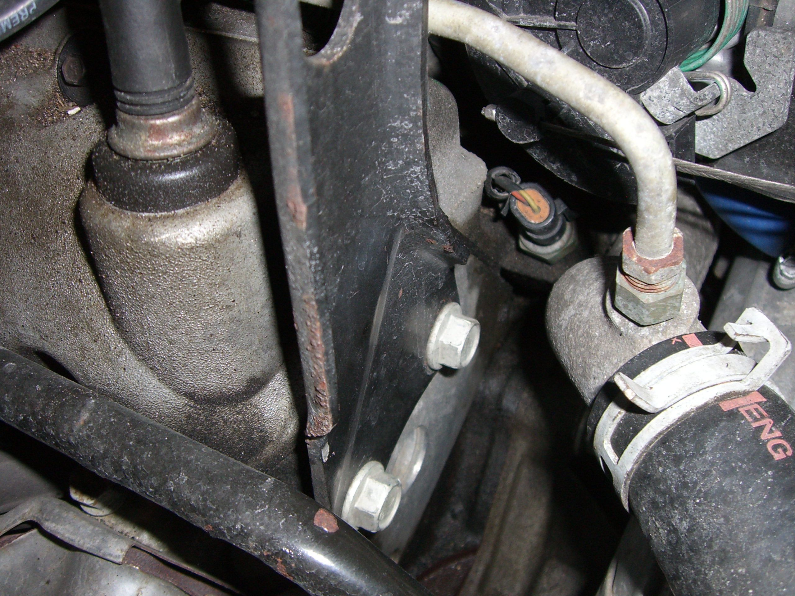

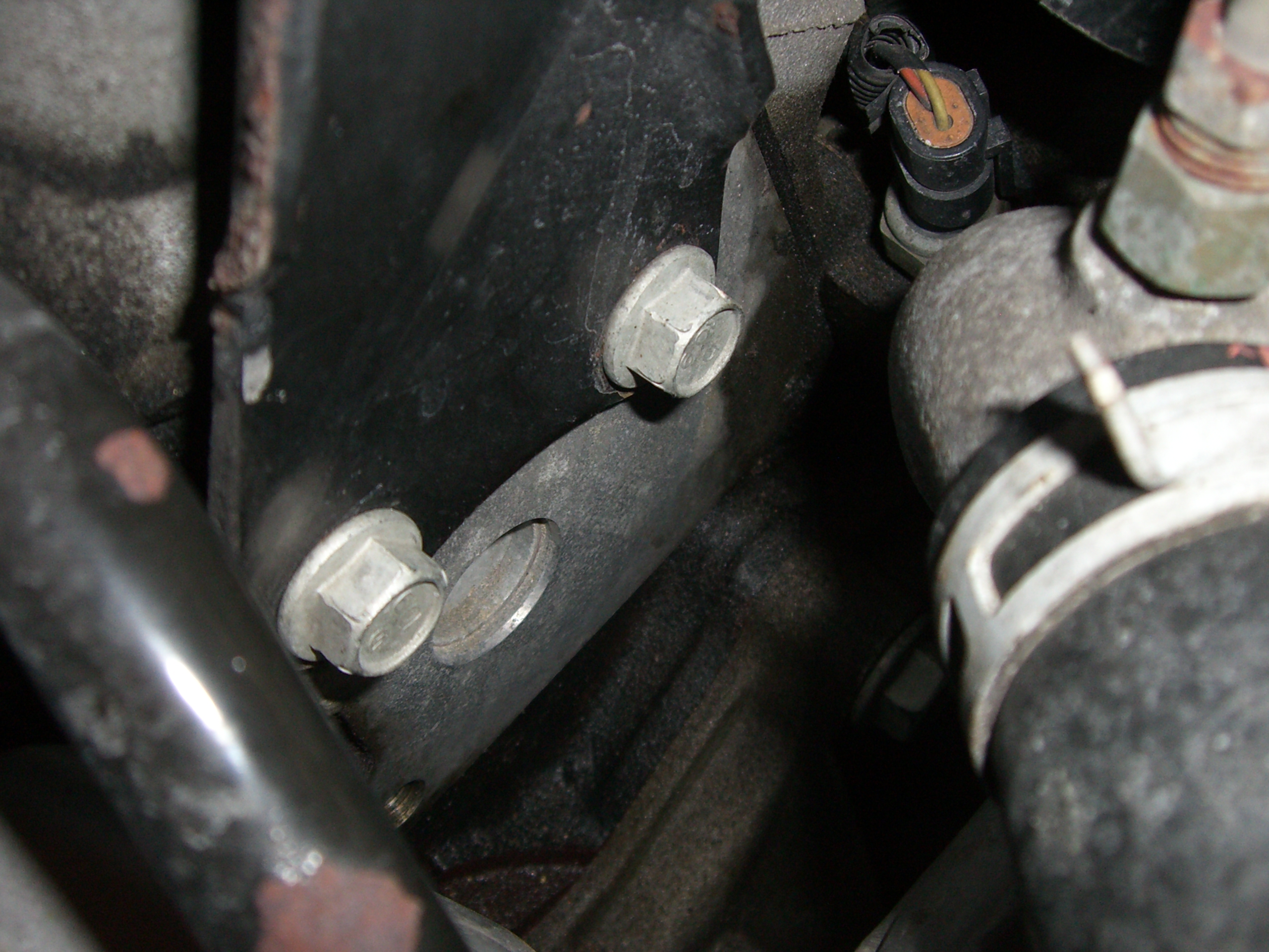

    Alright folks here are some pics.
    Sorry for the delay.
    I tried to take some pics of the passenger side as well but was unable to get a good shot.
    However over there there is much much less, just an eye drop.
      I wouldn't worry until you see oil in the coolant overflow..or the crankcase.
      Ken T.
        A little bit of seepage is normal/acceptable and is most likely just oil getting through the sealant used where the block meets the lower intake manifold. In any case, you'll know it's a problem when you start seeing drops of oil or coolant on the ground or direct cross-contamination of oil and coolant.

            Lol ironically the past few weeks i've been finding a drop here and a drop there but not a concerning amount. The level on the dipstick is still consistent
