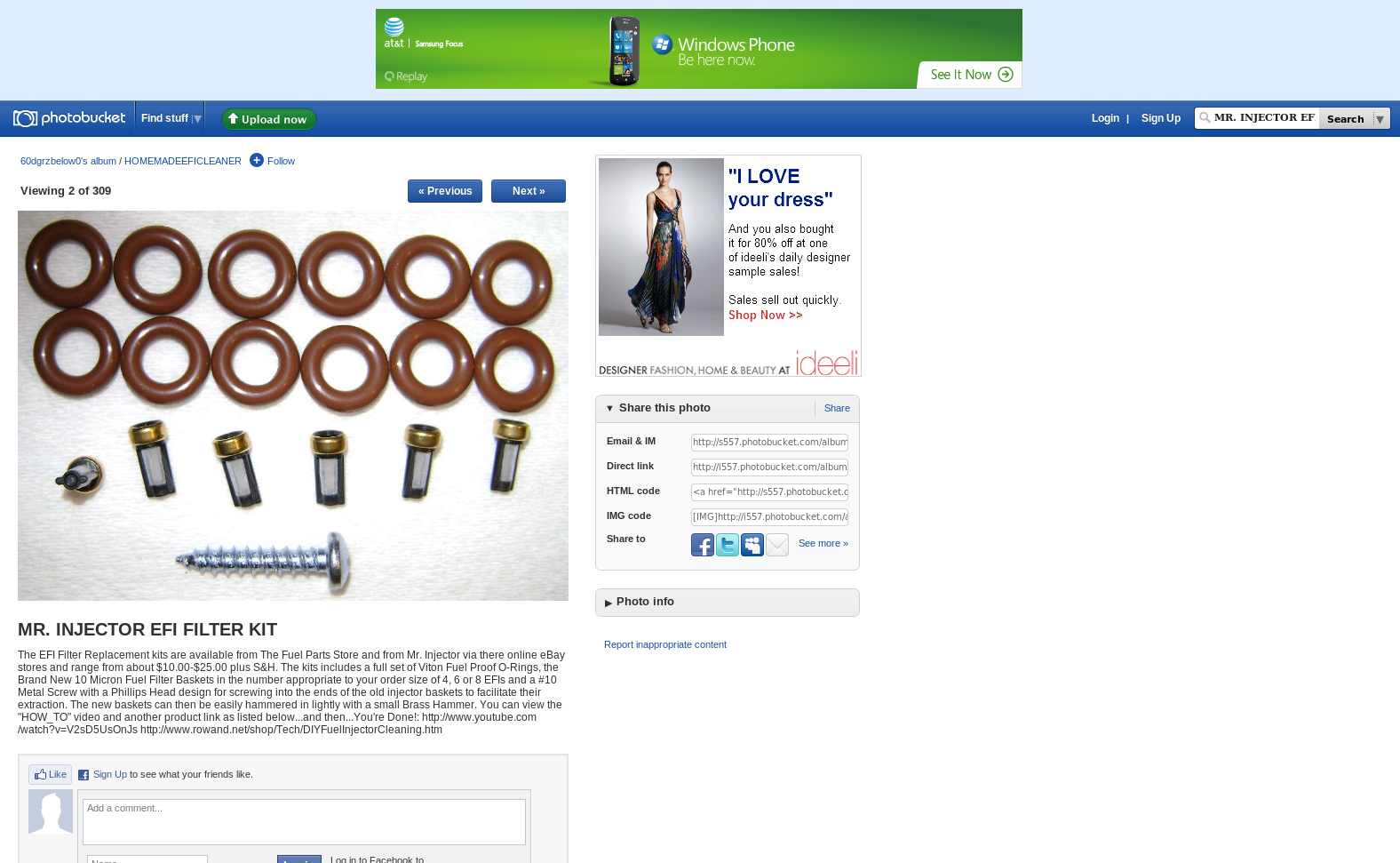

            Instead of trying any complicated EFI spray cleaning methods... you might be more satisfied with getting one of these Rochester Multec Fuel Injector Filter Basket Kits from ebay (around $20.00) and just follow the instructions on this video to R&R the old gunked up ones. After re-installing them, drop a large bottle of Chevron Techron into the gas tank and drive that baby around for a while to sort of wake the engine up at operating temperatures. Please look at the first two images on my photobucket link for the basket kit...and if you like, you can view the rest with videos at your leisure if you want to see the "Full Monty" of "The FrankInjector Machine" at work. Welcome Aboard...
            eBay has the Rochester Multec Filter Basket Kits for only $20.00 with Free S&H
            My Photobucket on this topic and "The FrankInjector Machine"
            The "How-To" video for replacing the Filter baskets on Rochester Multec Fuel Injectors
