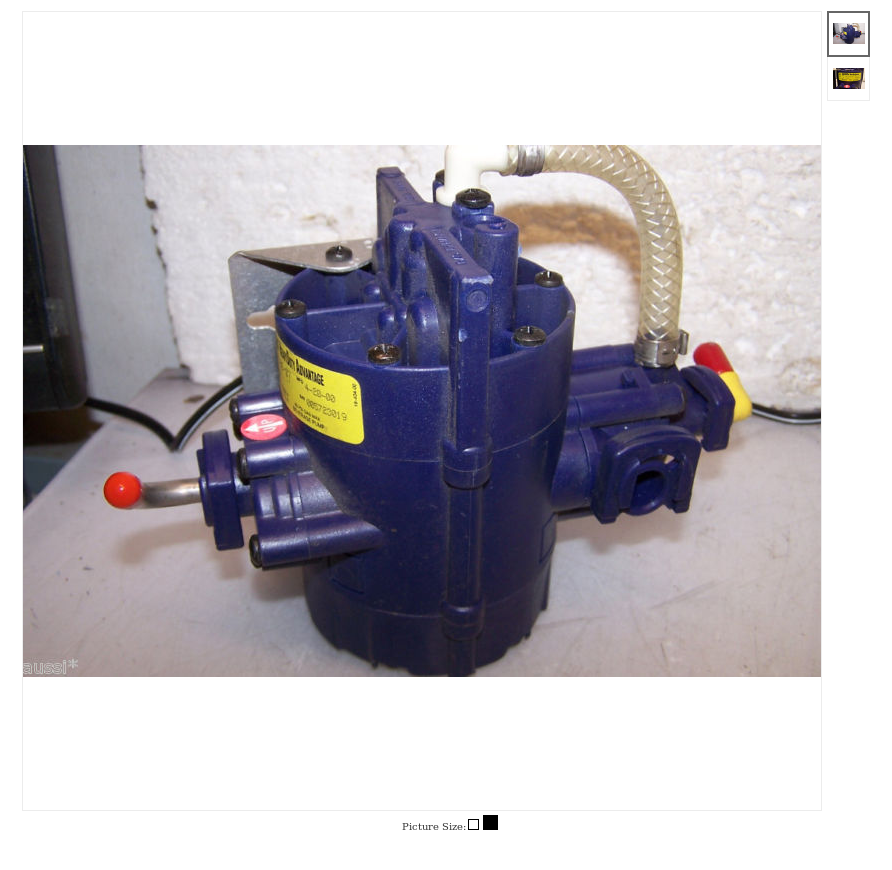

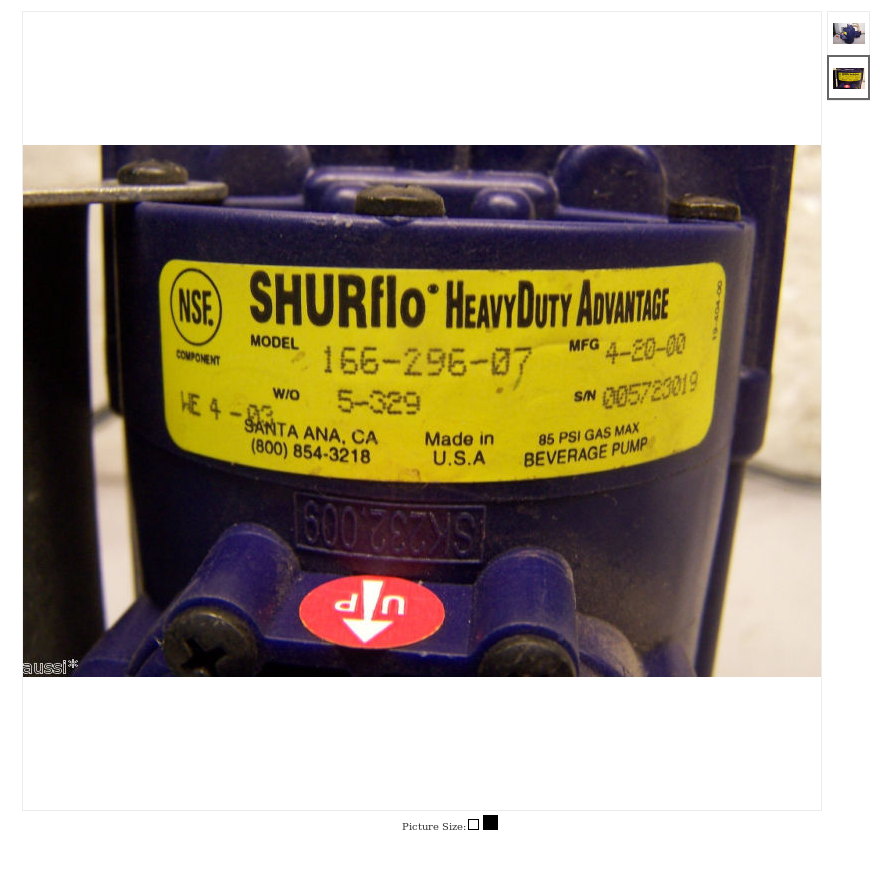

      I wish I had this damned thing designed, built and tested already. I mention this because if the R&D of this damned idea was finished, then anyone could buy the OTC parts and construct their own functional unit. Were it finished by now, end users like one of our members who is at this very moment concerned about this issue with his own engine; a long dormant LX9 engine would be able to quickly pump some fresh GM "EOS" Engine Oil Supplement and Motor Oil into his bone dry LX9 motor in the most convenient way possible. This would also have saved him from the hassle of having to R&R the Oil Pump Drive and then use an Oil Pump Priming Tool w/ Electric Drill to prime the engine. At the moment, this is the smartest and best suggestion he has obtained so far...(courtesy bszopi and also bob442).
      Meanwhile back in the design trenches... I've taken Pocket-Rocket's concern to heart over whether the really tiny pump I just acquired will have enough power to really push and pressurize the motor oil deep inside the block. This has prompted me to look at a company called SHUR-FLO at not only their line of 12 VDC Electric Water Pumps, But they also make a series of similar pumps that are designed to run via compressed air, metered carbon di-oxide or compressed nitrogen for use in High Volume Soft Drink Machines. The value of this technique has already been proven for me on "The FrankInjector Machine" by making it easy to precisely control the fluid pressure for the EFI Cleaning Fluid, so I feel confident it would work here as long as the line can take the pressure.
      The pneumatically operated pump would also solve my other concern over the possibility of having the electric version of the SHUR-FLO liquid pump spike or surge suddenly to a level that might accidentally hydraulically float the crankshaft bearings off of their seats in the block or even warp them out of shape in the process. Runaway hydraulic pressure can do mean things. The pneumatic method though would allow for a more gradual and controllable means of doing this; albeit with the need of an external compressed air/gas as the power source. Both of these pumps cost about the same and although they've been designed to pump either water or a viscous type of Coca Cola syrup... I think either of them would do well in this application. Here are some images of these pumps:

        Every RV company I've worked for uses Shur-Flo. You can't go wrong with them. I've installed them in anything from a 15 foot $15k travel trailer to a 44 foot $400k class A diesel pusher luxury motor home. They make a good product. Just make sure it's compatible with petroleum products (but you knew this ).
        • #19
          Yes I have thought about it lot ever since I read that it is supposedly designed for fresh water and concentrated soda syrup delivery systems. I considered that the oil might eventually dissolve any rubber seals and such...until I downloaded the PDF on the pump design. I noticed that it does not use a bellows style pump to actuate its internal development of hydraulic pressure. Instead, it uses a four hollow rotating plate to cycle the liquid in a manner that simply moves liquid into a position where it tries to squeeze the fluid out of the pump body and moves it down the line. This is possible in this situation as well, since all liquids are virtually incompressible...so the fluid either leaves the "Out" port under this compressive attempt...or failing that escape...blows the pump apart. But even with the failure staring me in the face, the fact is the pumps only cost around $45.00 on eBay and I'm willing to take the plunge and get one. R&D often means taking risks and if it fails the preliminary tests I have in mind to prove it out with before committing it to an actual priming job, I'll abandon this approach and come at the problem from another angle. Thanks for the experiential insight you have about its reliability, though. I'm still encouraged to give it a try..

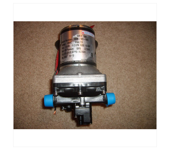

                BTW, IIRC The diaphragm style Shur-Flo's will generate around 45psi of pressure, so it would probably be ideal for engines. There are some with heat sinks on the bottom that have a circuit that will lower the pump speed as pressure builds and raise it when pressure drops. I forget what those models are called though (Smart something I think) but they are all black and have a larger pump head than the regular ones.
                    I think so too... After all ...the engine would not require the normal higher oil pressure of 65 PSI that it would if running anywhere from 650 - 5500 RPM... so 45 PSI would certainly be enough to get in and around all the bearing surfaces... Can you recall the exact model number of that SHUR-FLO unit? I want to be "SHUR" that I order the right one...

                      I'm pretty Shur (lol) it was any of them that was used for potable water. I can check the ones we use at work on Monday if you like though (along with the specs listed on the pump). They aren't the cheapies like the travel trailers, but I'm not even sure those models we used years ago are even available anymore.
                      • #26
                        Cool Beenz...that silvery looking one that runs on 12 VDC will be the first one I get since the PDF mentions its use in RV applications. I'll order it today and begin testing the assembly of all this HW some time next week. I was thinking that since they sell repair kits that include the gaskets... "As sure as there's Carts to Horses..." (Master and Commander Russell Crowe) I suspect I could get either some Neoprene or flat Nitrile material to make an oil-proof copy of the original unit encasement gaskets if it comes down to it. We'll see. Thanks for the update... this is encouraging.

                          Not a problem. You have more motivation for doing things like this than I do, which is why I don't mind offering up my thoughts and insight. Those silvery metal cased ones are the ones we used to use way back when (and I believe I've got one in the shed somewhere). The ones we use at Keystone are a bit bigger and have black plastic cases with a white pump head on them.
                          Edit: Actually I just went back and looked at the pic of the silvery one. That is not the style we used to use, but I wouldn't doubt it was a replacement redesign of the ones we did use.

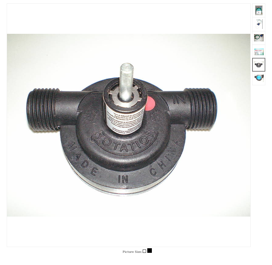

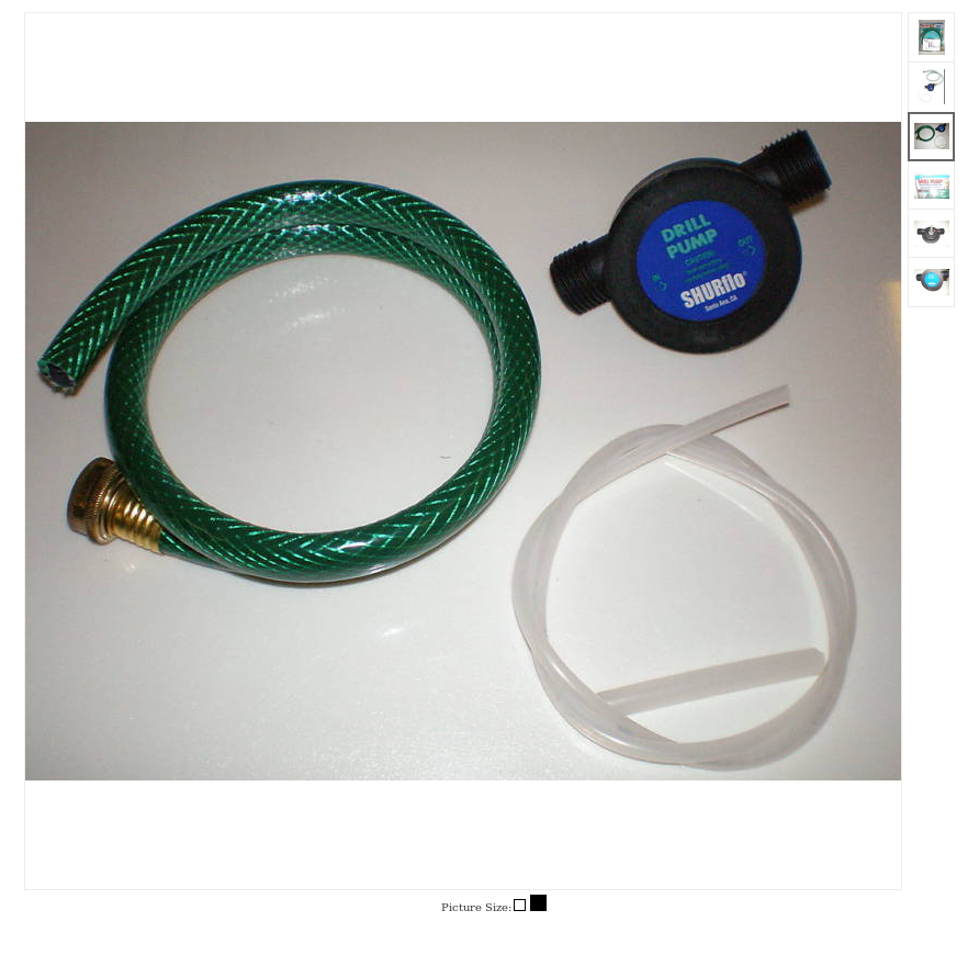

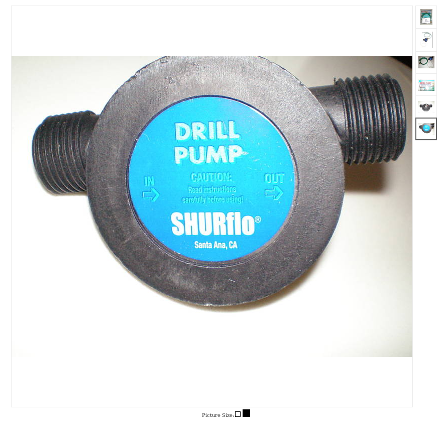

                            Pocket-Rocket... I just don't know what I would do without your stimulating conversations, Dude! (Poor Ben... I know he'll miss you...) Have a look at THIS...:
                            Jesus Palomino...Can it really be just THAT easy? ...And check out these specifications:
                            DRILL PUMP
                            Type: Flexible Impeller
                            DIMENSIONS
                            Length: 2.6 Inches Width: 4.4 inches Height: 2.8 inches
                            WEIGHT 0.5 Lbs
                            IMPELLER BUNA - N Flexible Reversible Impeller
                            PORTS 3/4 inch Male Garden Hose Fittings
                            ACCESSORIES
                            · 30 inch Garden Hose
                            · 1/4 inch ID Oil Changing Kit
                            PERFORMANCE
                            · Pumps to 216 GPH
                            · Self-Priming to 8 Feet Vertical
                            · Discharges up to 40 Feet Vertically with 5/8 inch Harden Hose <------------------------------------------------ Oh Yeah... It'll pump all right!
                            · Discharges up to 200 Feet Horizontally with 5/8 inch Garden Hose
                            · Pressure - Lubricated Shaft, Bearing, and Seal
                            Drill shaft—flexible BUNA impeller
                            TYPICAL APPLICATIONS
                            Oil change, winterizing, automatic transmission fluids, anti-freeze solutions, low viscosity gear and liquid transfer.
                            I've got a variable speed Roto-Tool motor that I could probably dummy up with something like a 3/8" Drill Chuck and then bolt the whole thing down on a mini-frame with the primary output line going into the FRAM C3 External Filter Cannister Body and then out into the....... next thing I need to make for this work......the Modified Oil Filter Manifold. I bought one of these just now... But if there is anybody else following this build/experiment...you might want to grab any of them if they are still left!

                              I may hop on one of those myself... The thing I like about it (besides it's awesome pumping specs) is that it has a flexible impeller, so if the oil won't flow, you won't bust off impellers using something like my half inch DeWalt drill. To move thick oil through oil passages you are going to need some power, so you might want to pick up a drill (even an old corded would work fine) at a garage sale, estate sale or Harbor Freight. I'm not sure a Roto-zip or the like will have enough ooompf to push it.
