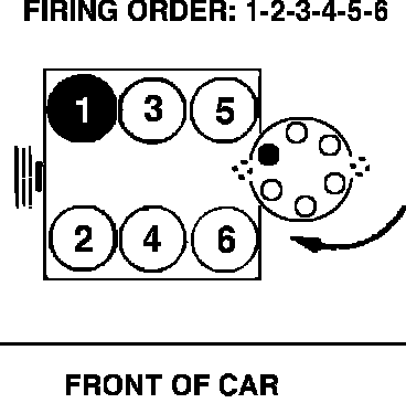

    Hello Everyone, I'm sorry if this is in the wrong spot to post. I'm a newbie and also tried searching this with no luck. I'm just trying to find a picture or anything that shows the firing order of the Distributor Cap on my '86 Cadillac Cimarron 2.8L V-6. I found the firing order of the engine (firewall side 1,3,5) (radiator side 2,4,6). Just trying to find how they fire on the Cap? Any info will help alot! Thanks!!
    this should answer your question.
      Robert...thankyou so much!! So make sure the #1 plug wire starts where the black circle is in the picture, then just go clockwise 2-3-4-5-6, and coil wire in the middle. Well here we go, gonna go try that out. Thanks again!!
