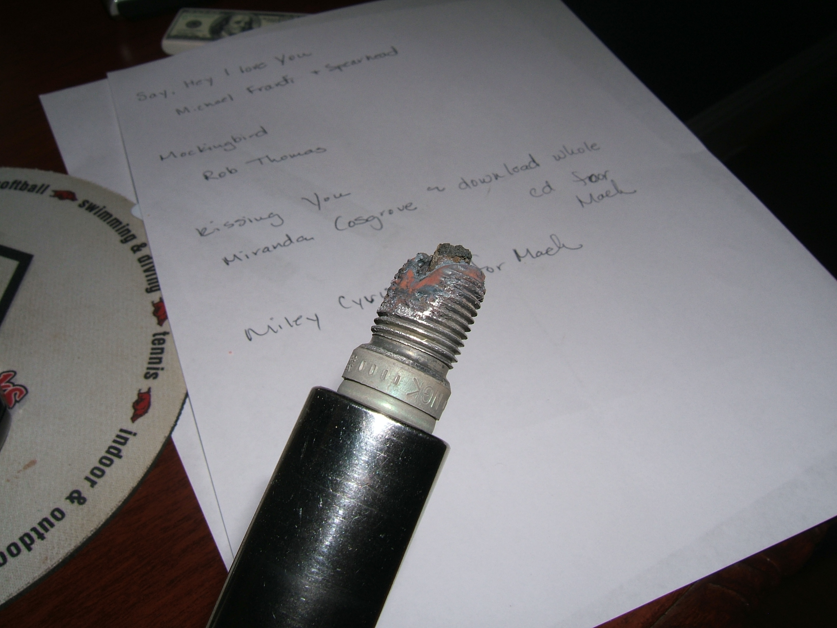

          Well, this might explain some of the issues, including the toy train sound I was hearing...
          Head doesn't look too bad... :crosses fingers:

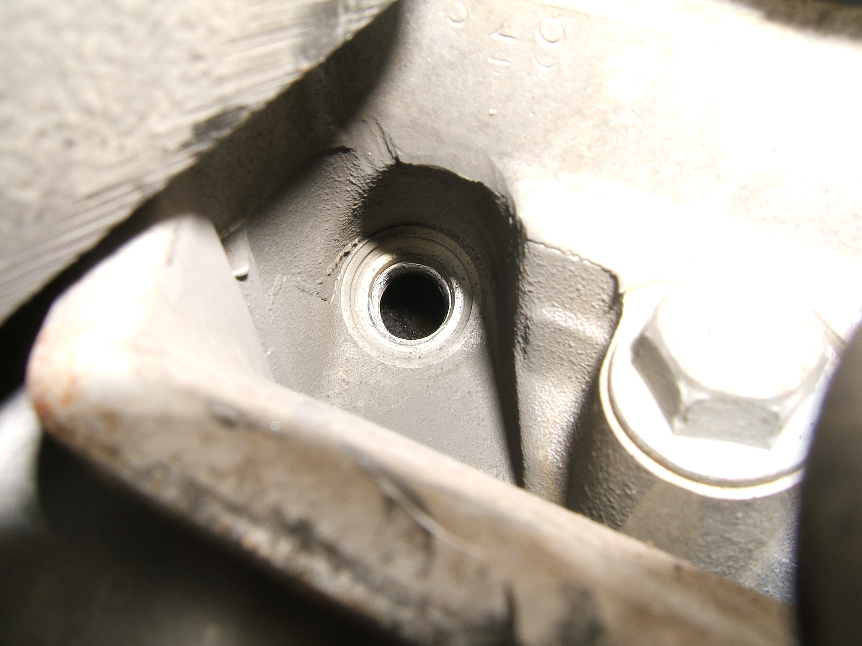

          • #20
            Anyone ever helicoiled a spark plug hole at home? I'm contemplating it, as the new spark plug appeared to be leaking as well. So I tore it all down. I've got the front head off, still need to take the plugs out to look at the hole better. Just trying to decide if I want to try to do it myself, then put it all back together tomorrow, or take the head to a machine shop to have them fix the hole, then reassemble Mon, and possibly Tues evenings.
            I may need to source a new crank sensor wire as well, as the current one got in contact with the exhaust manifold. It doesn't look like it melted down to the wires, but the 2 insulations are definitely melted together. And of course, I broke all 3 crossover studs, so I need to get some of those as well.

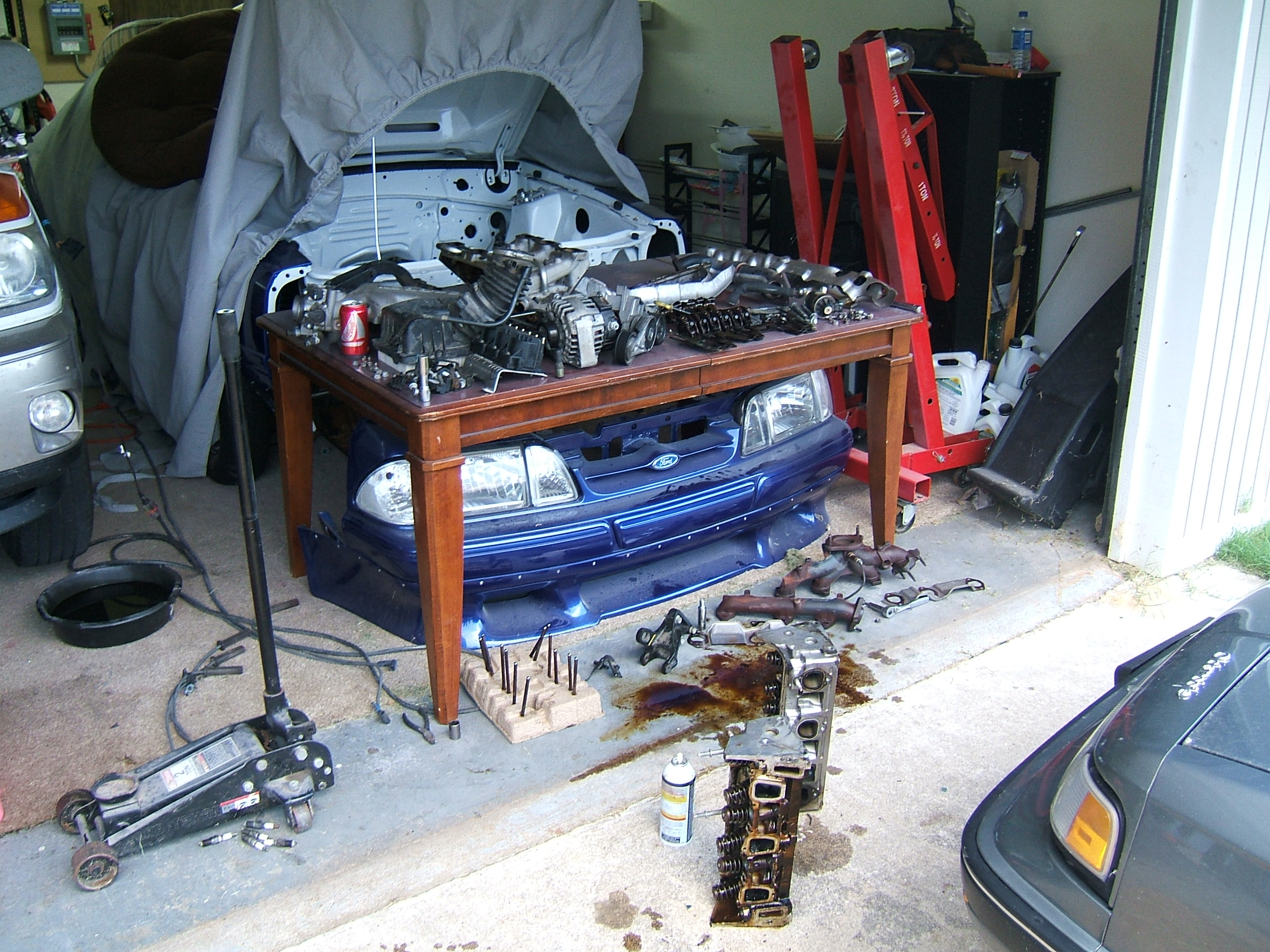

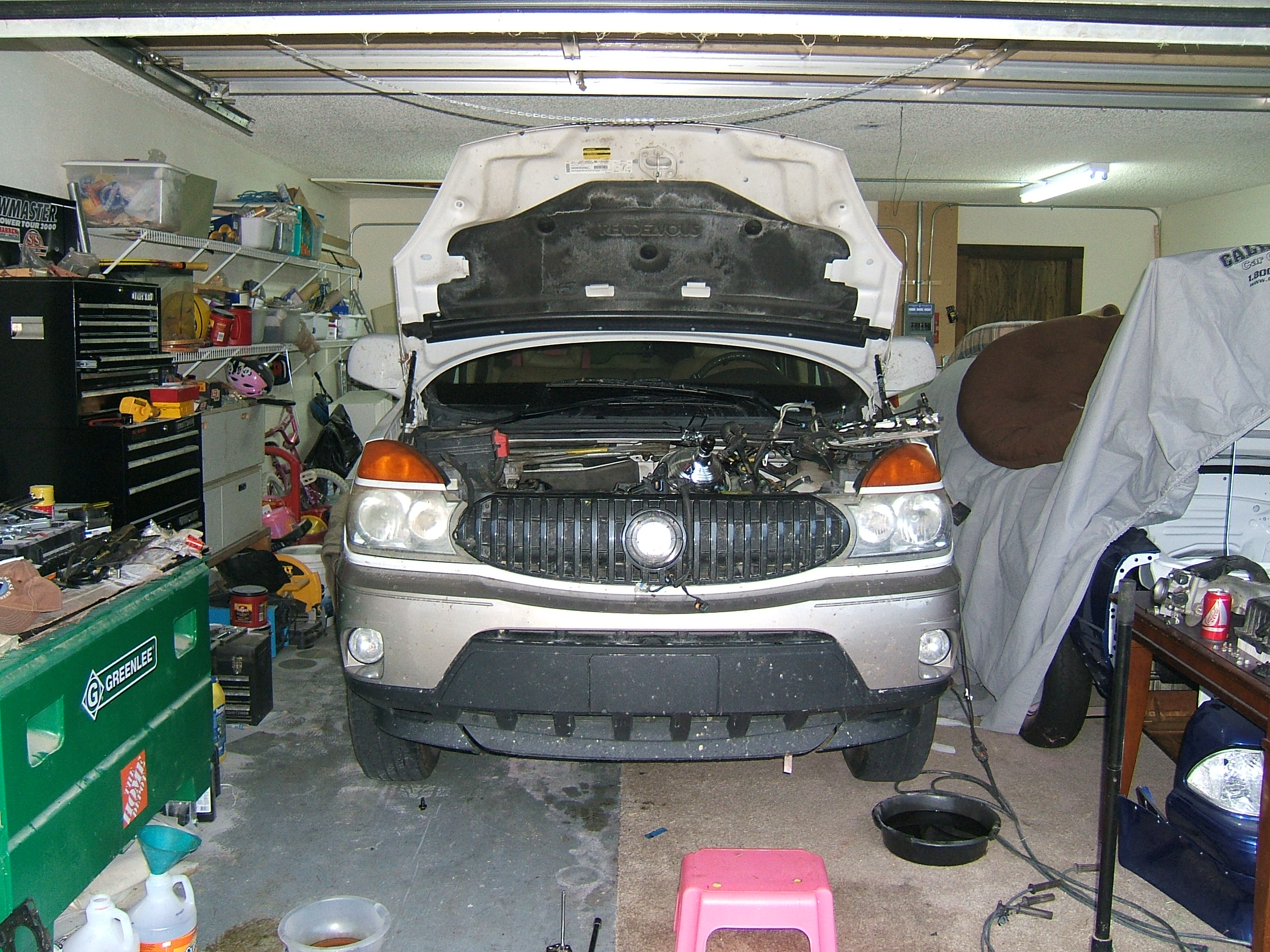

                  Ended up tearing it all the way down, and will be taking both heads to the machine shop tomorrow to get worked on. It appears that the spark plug in #2 wasn't the only thing potentially leaking. Had a broken exhaust stud there was well, and its inside the head, so I'll get to give the machine shop even more money....
ID:	374781 Click image for larger version
ID:	374780 Click image for larger version

                    • #25
                      Yeah, I know, as it indicates the intake port, which cross over the engine.
                      Anyway, just got a call from the machine shop. He extracted the broken exhaust stud, repaired the spark plug hole, and replaced the valve seals. He also checked for flatness and he was really suprised to find them perfectly flat. He said he almost always has to mill down 60V6 heads to get them flat. Checked them all out overall, and says I should be good to go. Doesn't look like I'll get them picked up today, but definitely tomorrow.
