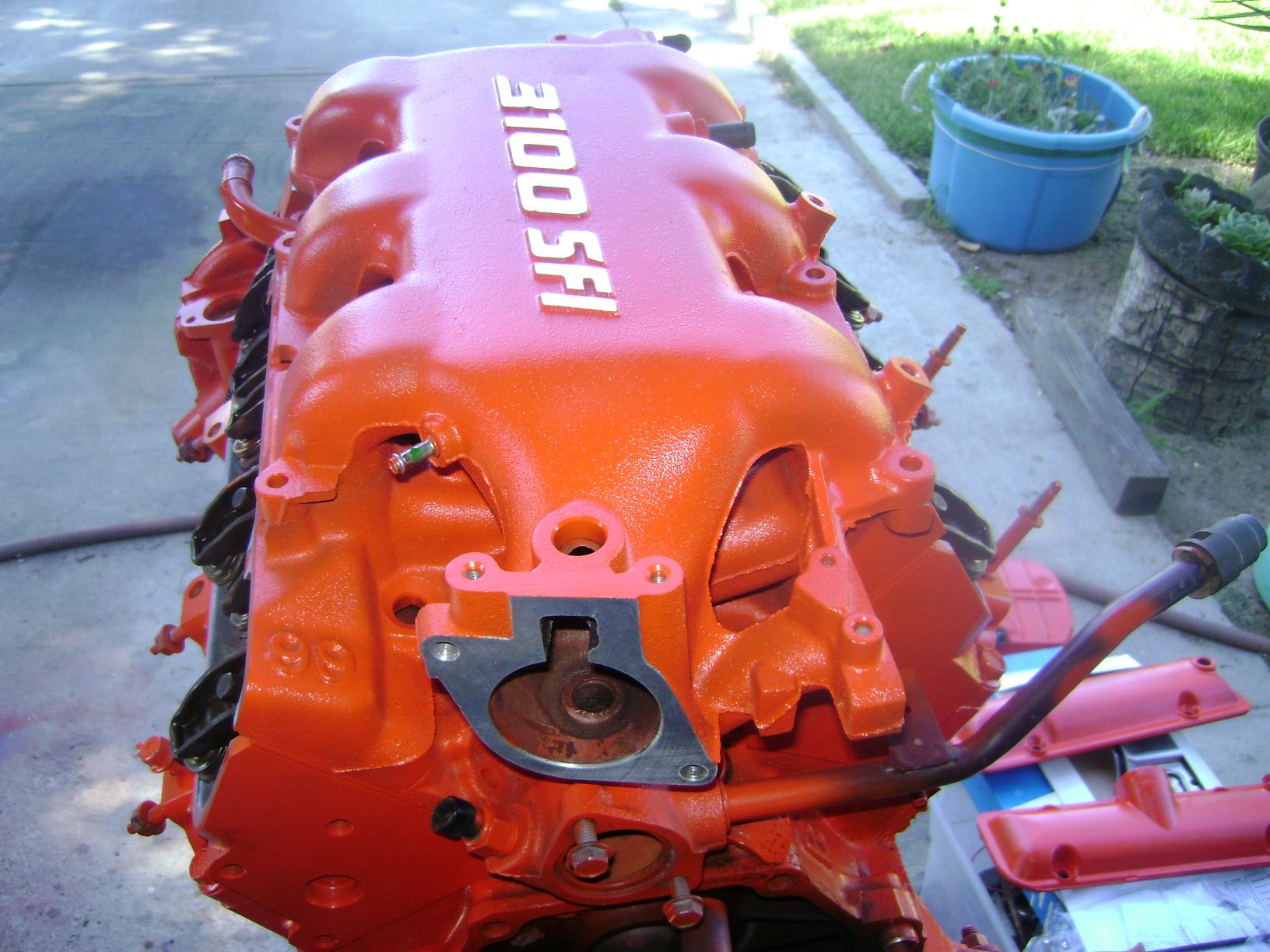

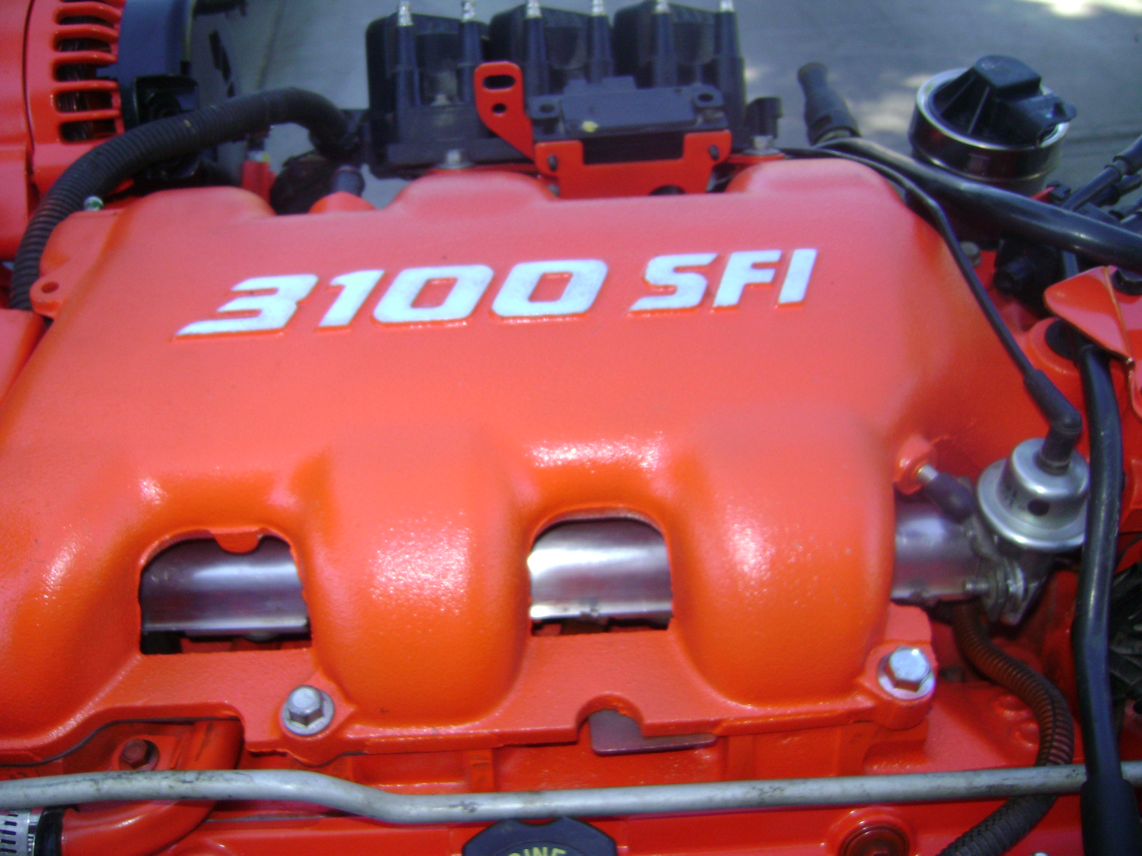

                            Maybe your engines to Orange? Painting an engine increases the engines temperature by 10%
