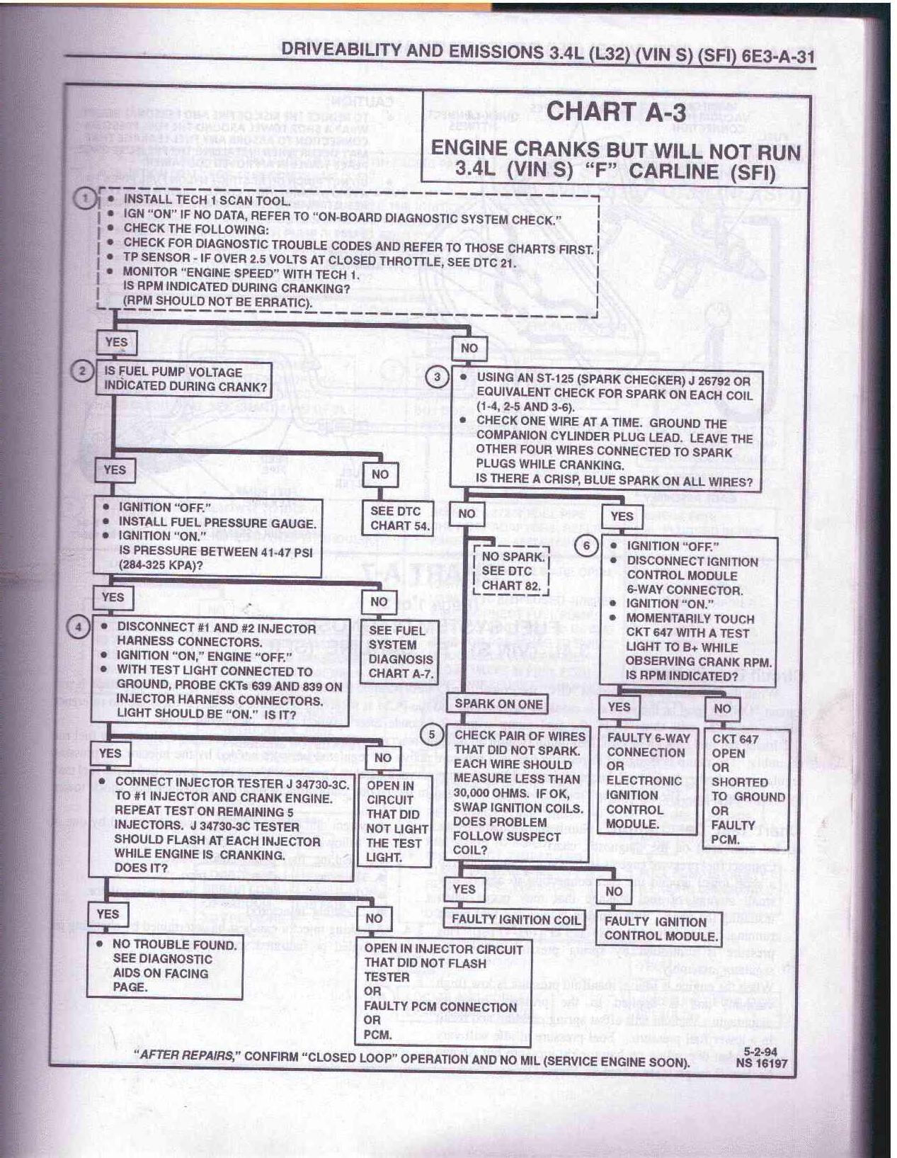

            I have been reading more in the Factory Service Manual (FSM). I found a troubleshooting chart that helped me realize what should be going on during the start process.... see attached FSM pages
            Open attachment page b [i.e. 6E3-A-31]...
            Step 1 - I do NOT see RPM changing. All I see in TunerPro is 300 RPM... whether the software is connected to the PCM or not. When I am connected, I see the Coolant temp, TPS and everything else... just no RPM changes.
            Step 3 - a couple weeks ago, I had spark at each plug. I discovered that the ones that weren't firing properly had the other side of the coil not grounded <smacking forehead>
            Step 6 - I do NOT see RPM jump in scan tool when I quickly tap 12V to the PCM... nothing...
            "NO" box below 6 says "CKT 647 open or shorted to gournd or faulty PCM"... swell

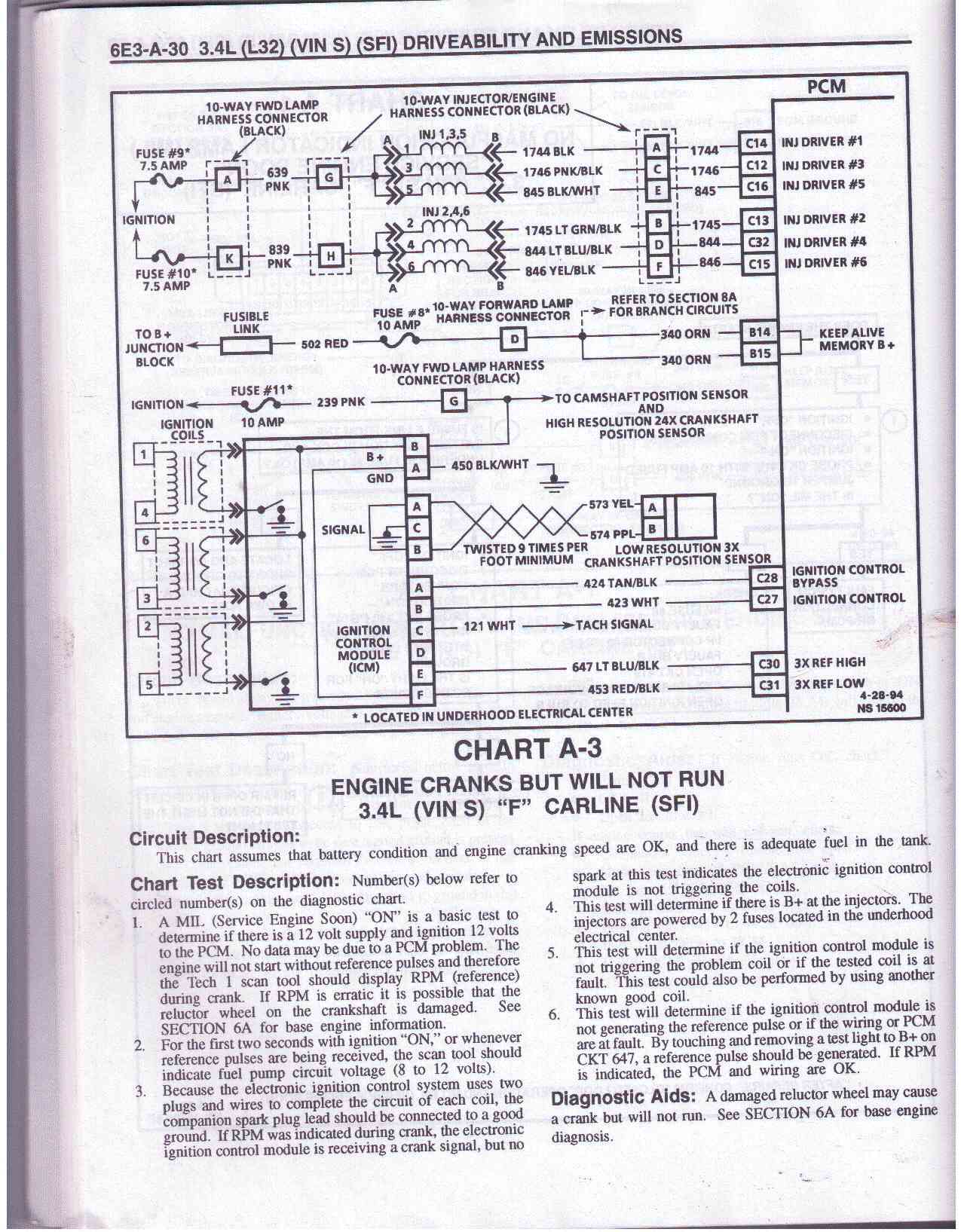

                            The Bypass signal is used to tell the ICM that the PCM will control the timing vs. letting the ICM do it. During cranking the PCM doesn't control ignition timing. The Bypass signal is high (I think, I may have the polarity backwards). The ICM is firing the coils using the crank trigger. Once the PCM sees that engine RPM is high enough that it thinks the engine is running, it pulls the Bypass signal low and the ICM no longer fires the coils on its own. Rather, the PCM uses signals from the ICM to know where the crank/cam is, and pulses the Ignition wire to the ICM when it's time to fire the coils.
                            If you have spark on all six plugs during cranking (which I think you said you did), I would scope out the Ignition Control and Ignition Bypass lines and verify that they're behaving. Bypass should switch polarity once it starts and you should see a square wave on Ignition Control once it's running. I'd verify this on the van to ensure you know what the signals should look like.
                            If there is a PCM/wiring fault I'm guessing it's in one of these two lines, though it's possible that the PCM's 3x crank trigger hardware's failed. I think you mentioned the PCM didn't register any RPM during cranking, which isn't a good sign but may be a red herring.

                              Expecting to find a bad connector or wire, I removed the PCM pins from the C connector that run to the ICM. I was unable to see the square wave at the PCM.
                              Since the wires at the ICM are down near the water pump, I decided to remove the coils and ICM... and just test with it sitting out. I connected a probe to the pin on the ICM that should have the square wave on it. I plugged-in the power connector and the crank sensor connector... nothing.
                              Doubting my testing methods, I decided to try that on the Olds. I removed the coils and the six-wire connector at the ICM, connected the probe to the pin that sends the 3X ref signal. The o-scope logged a square wave. That confirms my testing method was valid.
                              Wait... what is that?
                              The wires to the crank sensor are in different places!
                              The plug on the ICM that runs to to crank sensor is a 3-pin plug. On the Camaro the two wires are connected to the middle pin and the one farthest from the 6-pin connector. On the Olds, the wires are connected to the two outer pins of the connector - the middle pin is open.
                              If you look at the diagnostic wiring diagrams I posted last week, you'll notice the diagram shows the wires with a not-connected center pin. hmmm.
                              Out of curiosity, I moved that wire to the outer pin. I now have the square wave coming out of the 3x ref pin!
                              I put all the coils and wires back on and connected the injector harness.
                              The stupid car still won't start! I connected my scope to the 3x ref pin on the PCM. I can see the square wave at the PCM. I connected my scan tool [TunePro RT], and the RPM value is still 300 rpm all the time. I'm beginnging to wonder if the scan tool has the data stream defined properly.
                              The engine fires, but it won't start. I told myself it was because the plugs are too wet. I'll clean the plugs later and try again.
                              At least I have my square wave, now.
                              All the wiring looks OE. I wonder why the car ran before with the pins next to each other, but now the ICM won't generate a square wave with either the Camaro or Olds ICM <shrug>
