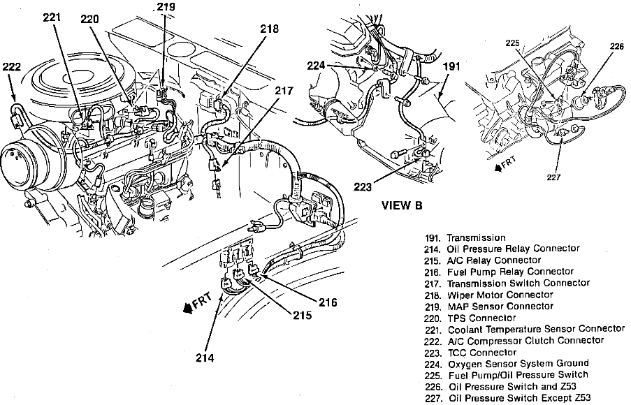

          this pic should help with the relays...
          and i can't find a decent description as for why there is a relay for the oil pressure guage...

              Thanks for that pic robertisaar, that may clear up some of my mystery wiring. That pic shows the center relay as being the A/C compressor relay which being an A/C truck mine should have. However the PO had 'upgraded' to a Sanden compressor, so it looks like he took out that relay when he took out the original compressor. So some of those extra wires are probably A/C relay wires. Only the coloring does not match up at all with the Mitchell's coloring of the A/C relay... I'm really going to have to find another '87 to match this all up.
