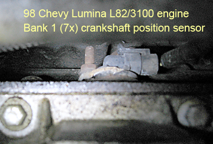

    I have a 98 lumina 3100 L82 engine and need to replace the 7x crankshaft position sensor. I can see it but can't figure out how to get a tool in to pull it out and replace it. Does anyone have the service manual that yo could post the page or two with description on how to do this. I have attached a picture of what I think is the sensor. I cannot figure out how to get a wrench or socket in the spot so maybe the book tells how to do it.

    Service manual wont help, just says remove lol.
    I have used a combination of extensions and flex' or just reach in with 1/4" tools.
    I have a hoist though which makes it simpler.

        From GM SI
        Originally posted by SI2000
        Disconnect the negative battery cable. Refer to Battery Negative Cable Disconnect/Connect Procedure in engine electrical.
        Crank steering wheel fully to the left.
        Raise the vehicle. Refer to Lifting and Jacking the Vehicle in engine mechanical.
        Disconnect the sensor electrical connector.
        Remove the attaching Bolt/screw.
        Remove the sensor from engine.
        Inspect for wear, cracks, or leakage if the sensor is not being replaced

          Do not have to lift engine, just think like a monkey though and reeeeeeach lol.

            To put into perspective; Mitchell says it pays 0.7 hours.
