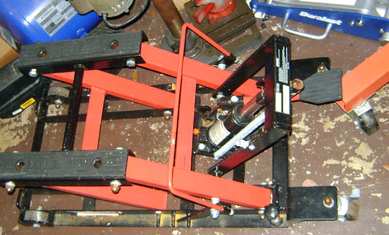

Tommorow... I'll be picking up a section of thick, plate steel (an old welding table) that I will cut with an Acetylene Torch down into a rectangular segment narrow enough to fit inside the splayed legs of my Cherry Picker-Engine Hoist. I have a Very Heavy Duty set of roll-around wheels to install on all four corners and this will serve as the means to lower and capture the Engine/Xnsmission Combo and wheel it out from under the car. Afterward... I'll remove the Jack Stands from the two "Towers" and adjust the two wooden platforms enough to lower the car down and have it resting safely so I can dress up the engine well and get things ready for the new motor. As always... I'll be methodical and careful and document these activities with digital images and videos and share what happens on my Photo Bucket Site for all to see. Here are the beginnings of the work to be done on this project:
