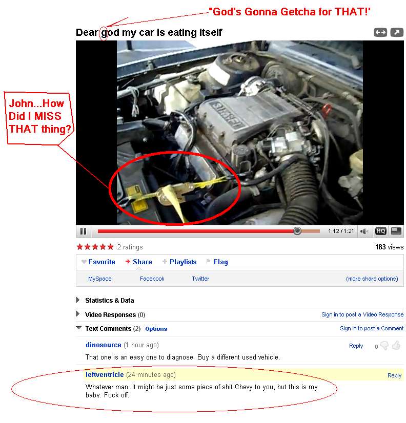

        Something to watch while we wait for him to come back inside and say what happened...one way or the other...
        John...Seriously...?
        http://www.youtube.com/watch?v=ff-SEUcD-jM
        Pause the video at :43 and put your glasses on :P You will see a yellow ratchet strap in place of the upper motor mount (aka dogbone).
        And, Bob, I DO know what a ratchet strap is! I have about umpteen of them - no need to show a video ROFL.

          You need something like this to tide you over...but a lot closer to Vegas...
            OMG !!! That is the guy I like to call "SHIRTLESS... BUT NOT DIRTLESS"
            Please take no offense... the video was for ME to kill some time until the poor OP managed to get back in the house and breathlessly tell us how "Unlucky in Vegas" one can really be. ! (I've never used one used by the way...but Good Eye for spotting one here...LOL)

            • #21
              Check this out...I've gotta give it to you, Vent... You not only take your car seriously...but you get HIGH MARKS, too for that category called: "Acceptance of Criticism"
              (See Attached...)
              • #22
                (See Attached...)
                Yeah, I had just made the second video when I saw that comment, so I was a little unhappy. As for the strap, the aluminum bracket that the dogbone bolts to broke, leaving me without an upper mount. That strap was supposed to be temporary; I put it on back in August. I am almost finished collecting parts to replace that bracket, along with the head that got damaged, and this happens.
