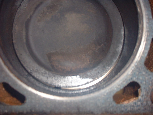

                      Piston slap, it'll quit once the piston is replaced. Remember GM had a problem with this. Note the gap between the wall and the piston and the ring gap. This was on a 2000 3100 that I picked up as a near new pullout due to engine noise that turned out to be piston slap once I installed it and discovered why it was in such new condition after the fact. The picture is after about 30,000 miles of turbo abuse. The #6 piston was on the brink of failure with a severely damaged and scuffed skirt. That's it you see in the picture. Revving hard will push you closer to piston failure. You can stick your foot through that ring gap. The car still managed about 25 mpg with iron heads on the motor. Very low compression.
                        Hello Joe...It's nice to see a Fellow Forum Brother local to the Tampa Bay Area...
                        Yikes... Just LOOK at that cylinder! Why...you could drop a Boiled Ostrich Egg down there, sideways with NOoooo trouble! Did you have to sleeve the block to fix the problem?
                          No sleeving necessary, I fixed it with a 3900 V6. The engine ran fine it just made a lot of racket which is why it was removed from the car it was first installed in. It would quiet down from time to time initially but it eventually got louder and a few months prior to its removal I really got on it hard with 7-8 psi of boost and probably near 7000 rpm while passing someone and I noticed it was louder afterwards and sensed it was only a matter of time before it failed. There is a picture of the piston in a "dissected 3100" post or thread by me here somewhere to show how bad a shape the #6 piston was in.
