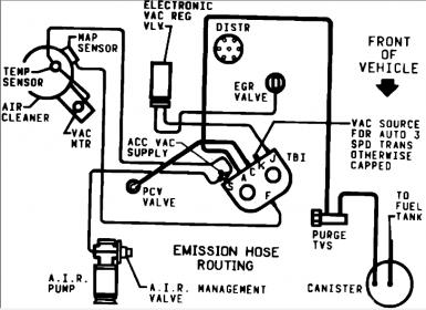

                          I was wondering if anyone had a diagram for the vacuum lines for the egr routing? 2.8 S10 TBI.

                            need more than this?
                              I think that should do it! I just need to wait for a non-rainy day to get out and figure it out. Thanks again for all the help guys!
