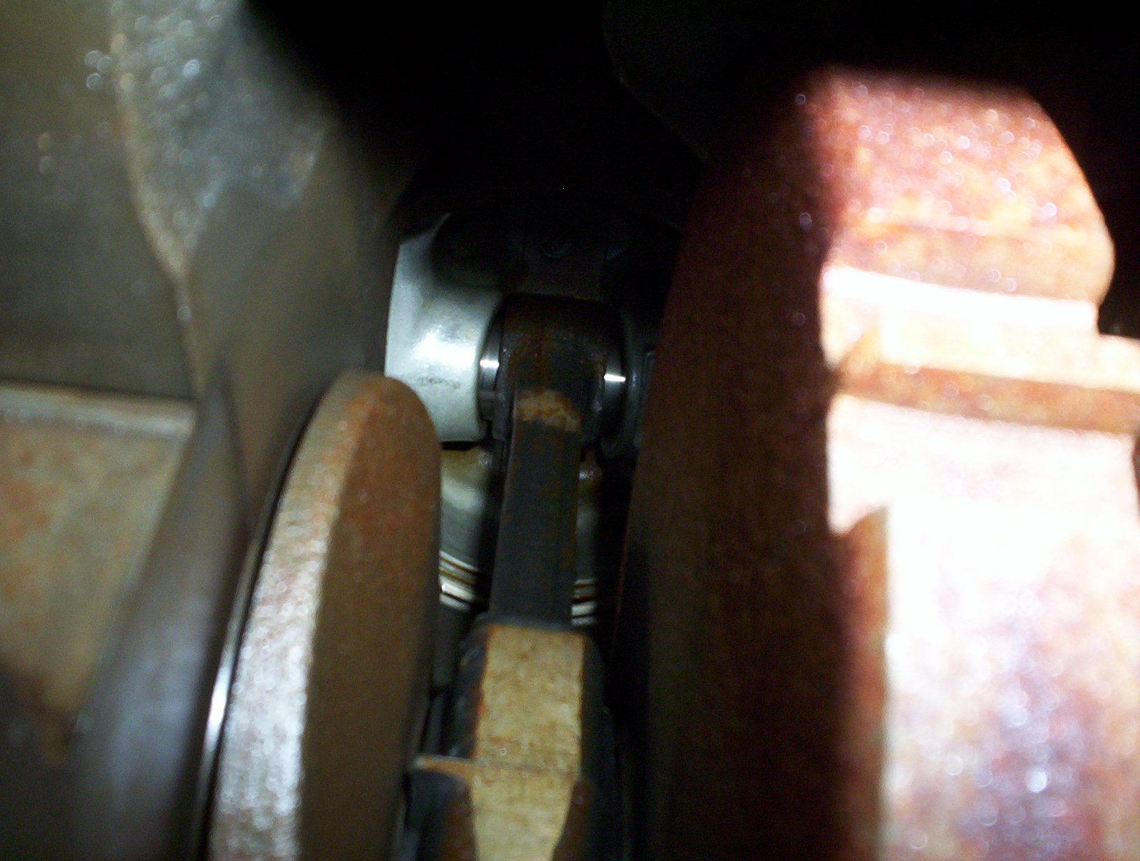

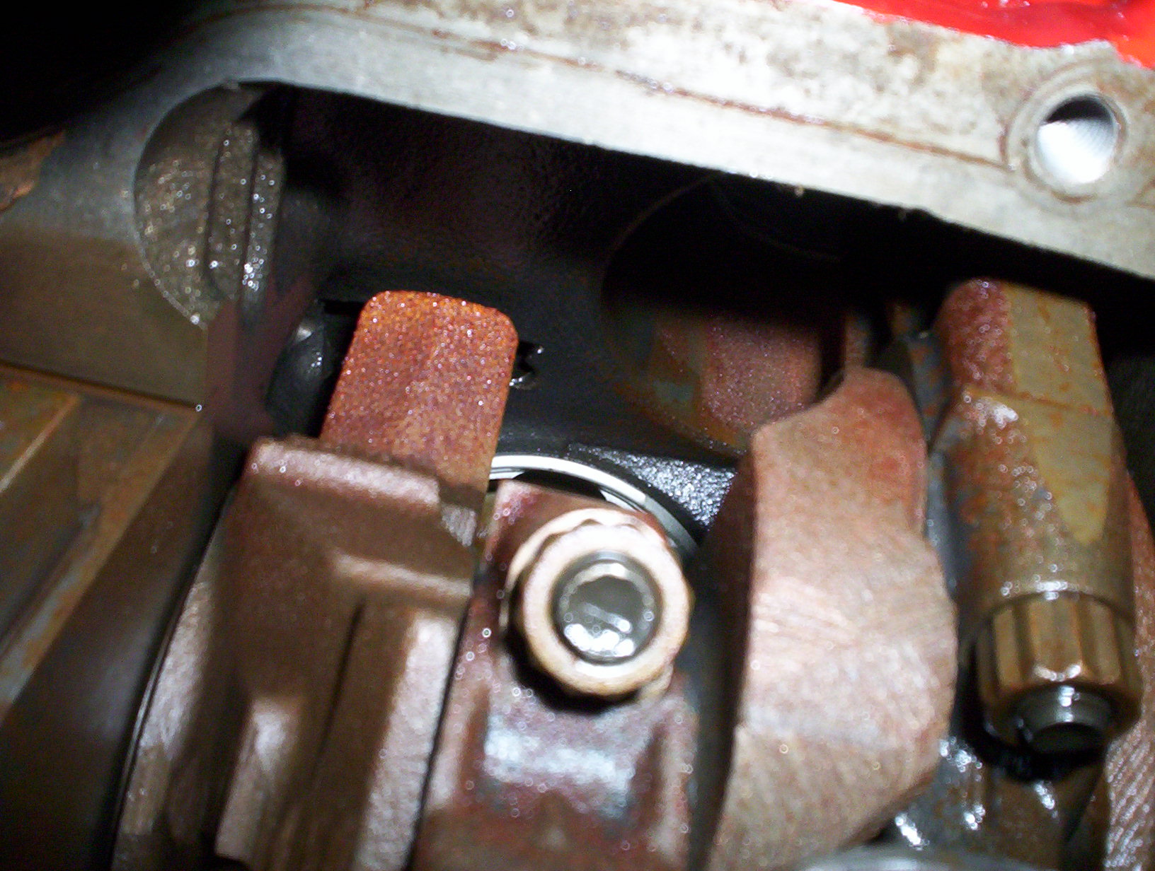

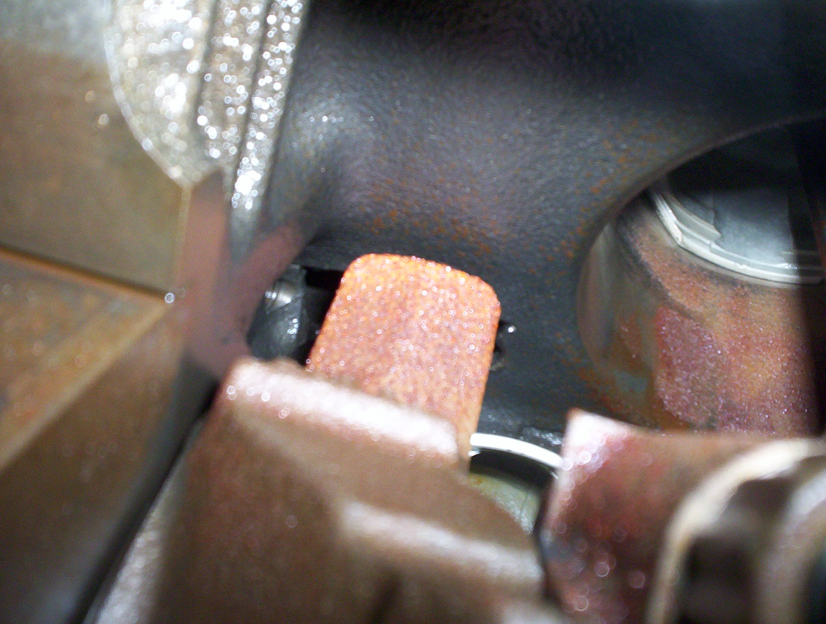

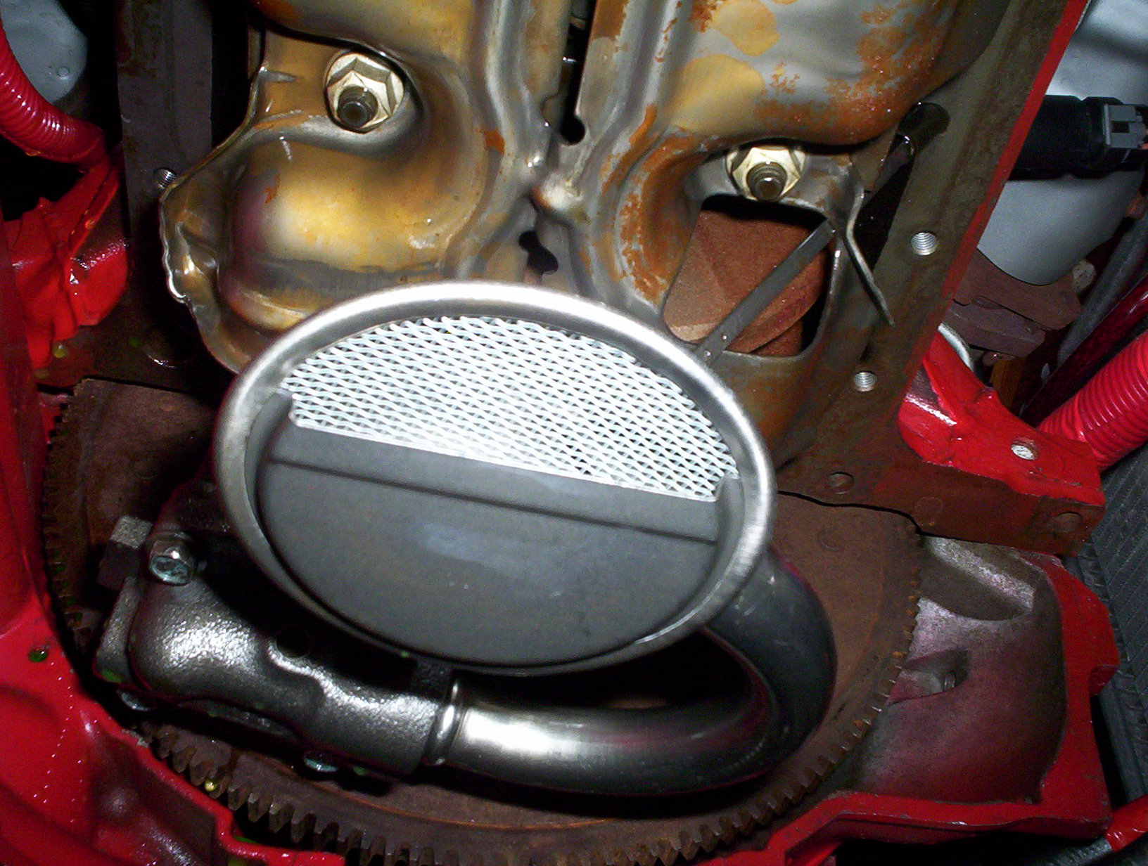

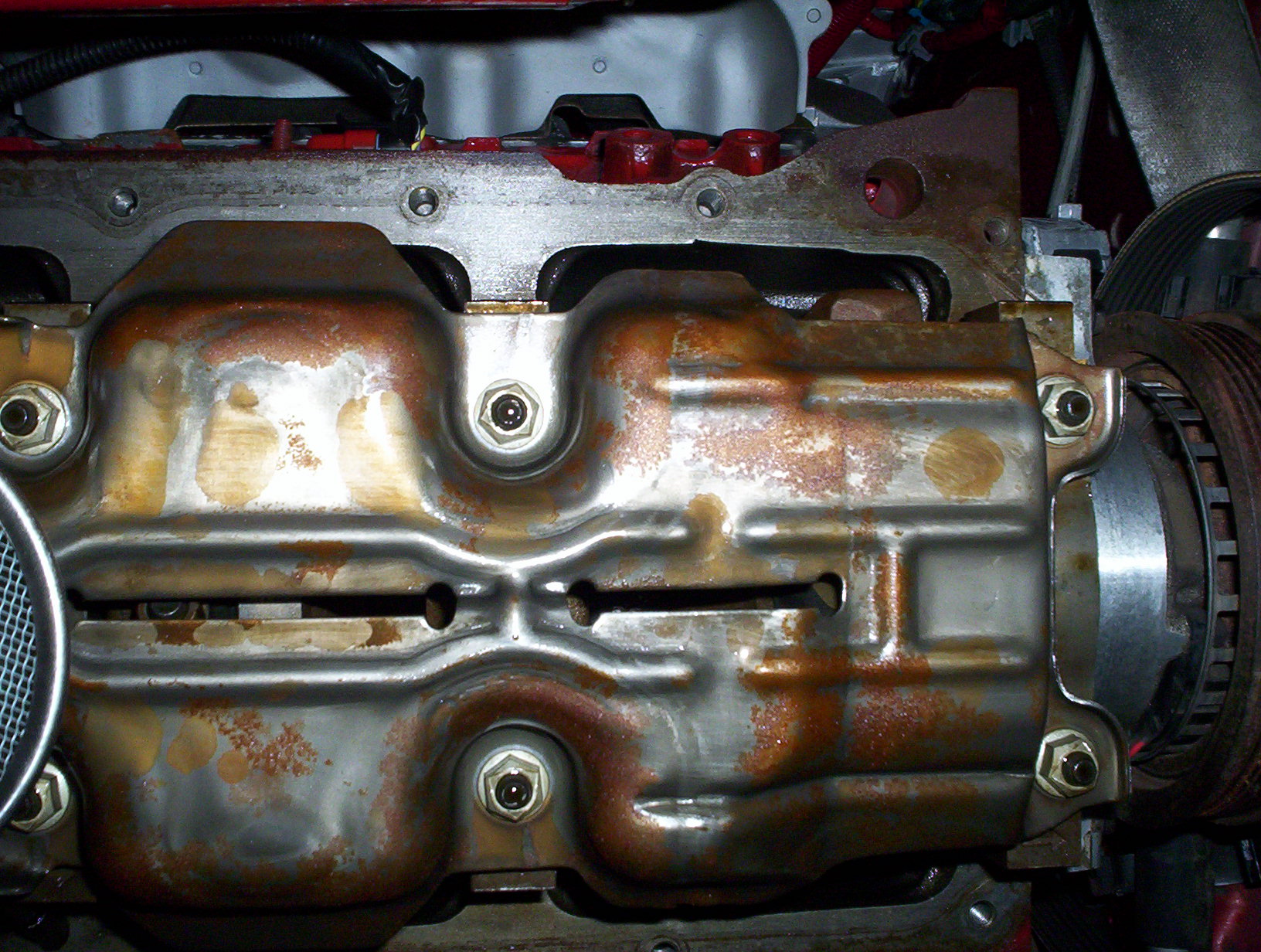

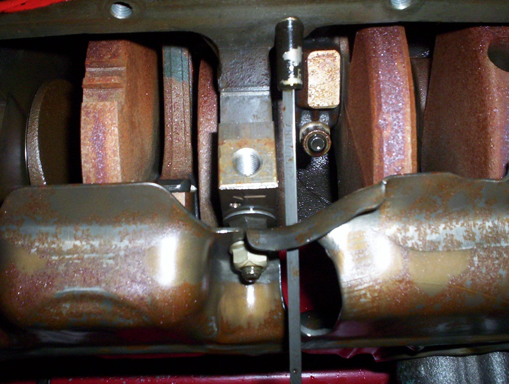

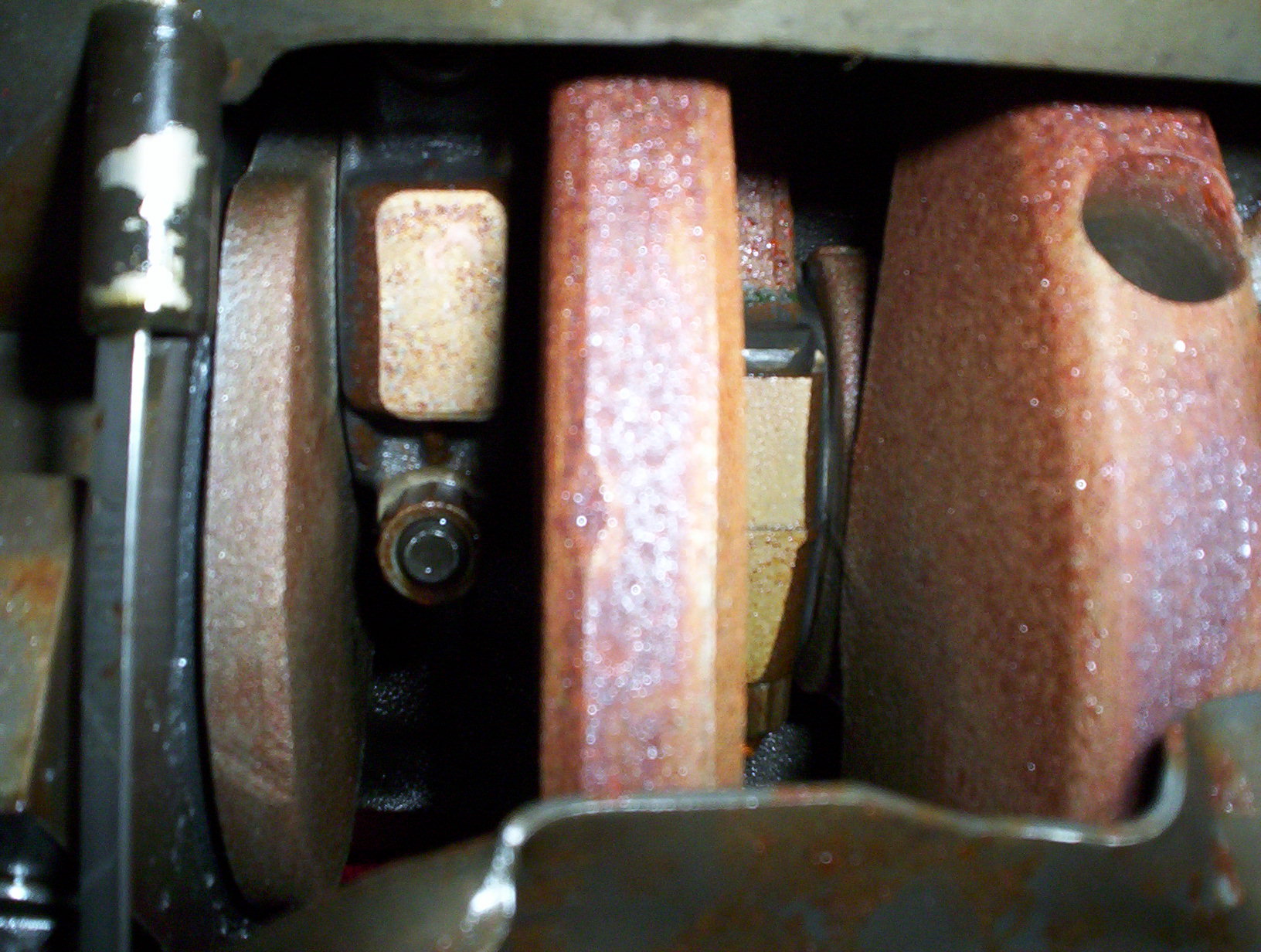

          i tried looking it up but couldnt find it so i took some pics to show you guys what im dealing with. i left my oil pan off all winter like a dumbass and now the entire bottom end is rusted out which makes it even worse since its ran with no oil pressure for about 10 minutes idling but the rods never knocked just the top end ticked. so should i overfill the motor with oil and let it sit for a while?

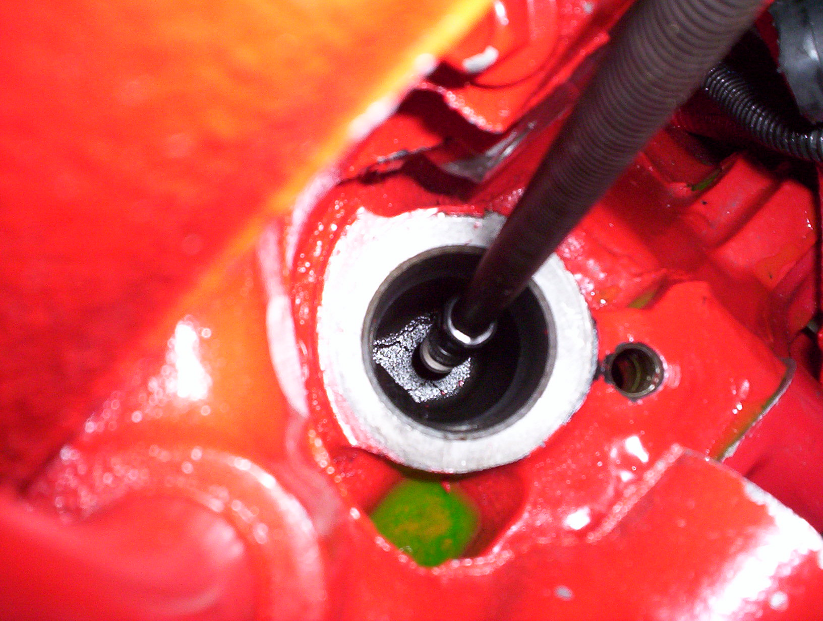

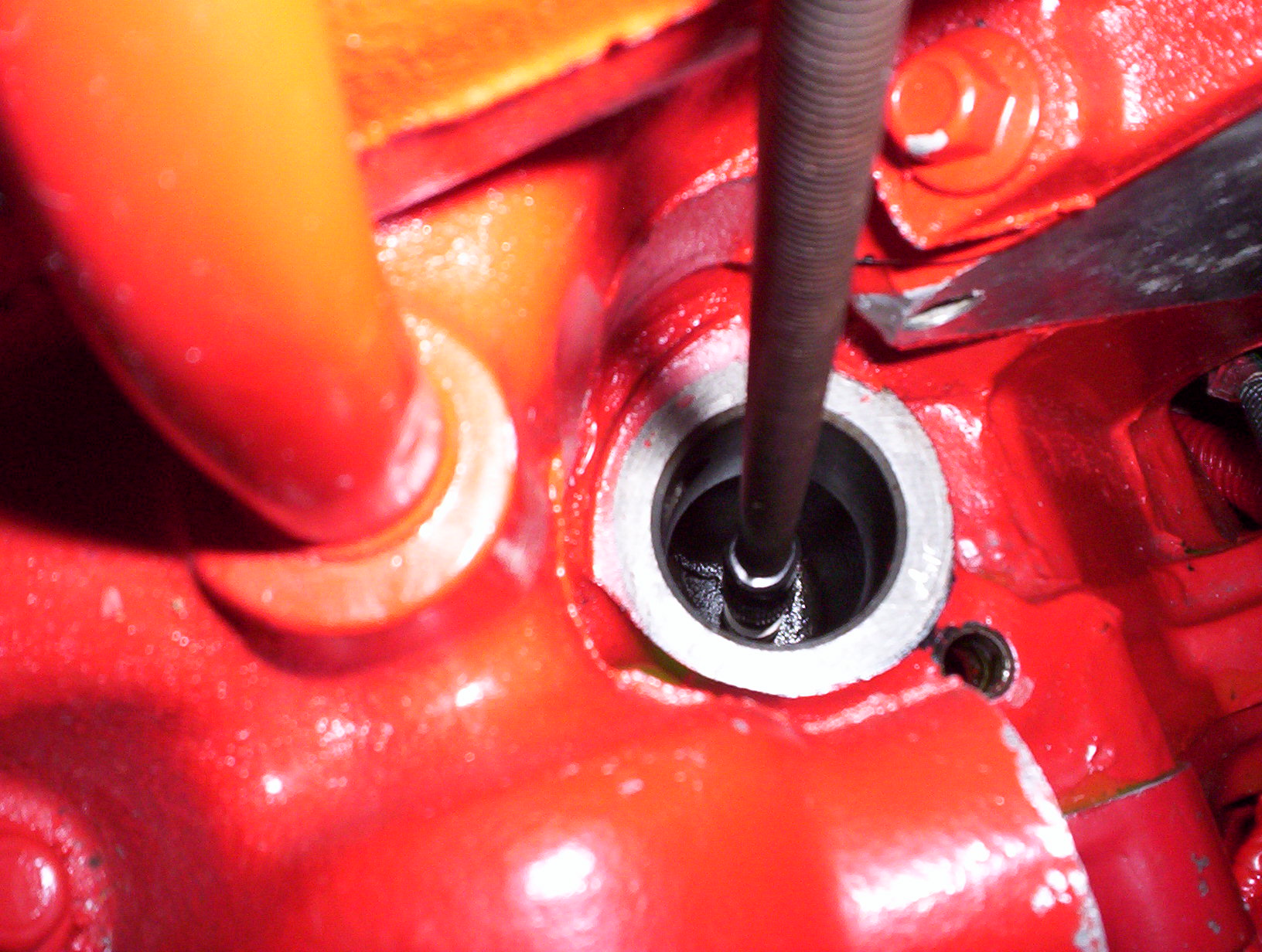

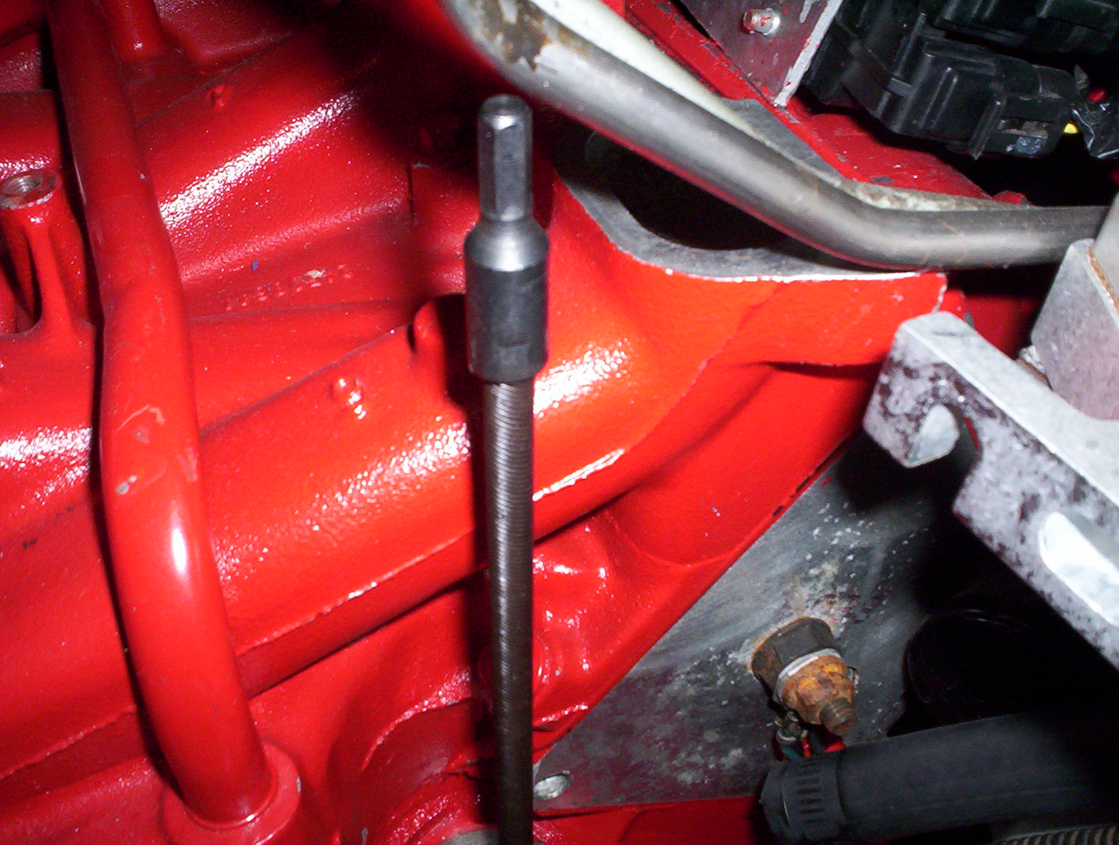

          i also have this extension that came with a drill bit set that fits but doesnt seal the entire opening like the pump gear drive does think it'll work to prime the engine? and which direction should i spin the drill?
            shove a rag around the bit and it should be ok.. i forget what direction to go but you'll know when it's pumping.. lol
              Your going to destroy a set of piston rings when that engine starts again. The cylinder walls are dry and have to much rust on them.

                yeah all the rust has me concerned so im getting ready to go bolt the pan on then fill the engine up with tons of oil and let it sit for a couple days before i attempt to prime it or turn it over by hand and i think the pump spins clockwise on the drill guess we'll see.

                      yep. well, 3 years doesn't say much. but it's been running fine for at least 20K miles. also had the oil plug out and the filter off to boot! though, my cylinders weren't as rusty as yours. if you plan on your rods living, and while the oil pan is off, why not take a little time to remove all of the caps and put some assembly lube on the bearings. won't hurt to squirt some oil all over what you can get to.
