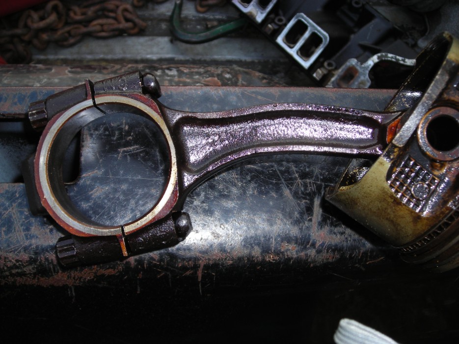

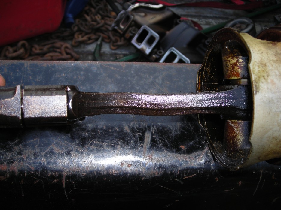

    I doubt you broke a rod. Here is what happens when water gets in the cyl while the engine is running...

    The rode are forged, they will bend before breaking.
    BTW, these cam out of a running car (just not running good ).

        They weren't from my car, but came out of a 3.4 Camaro.
