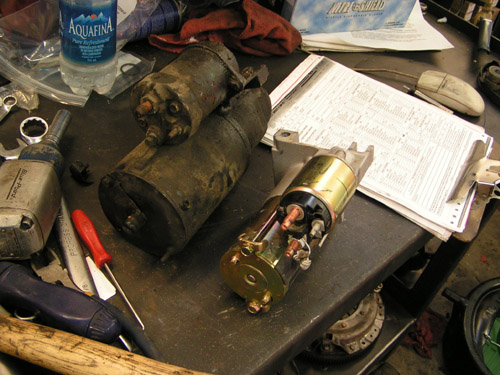

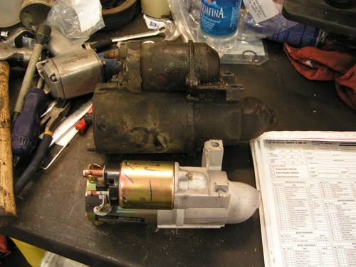

Then new compact starters work great. I think they sound much better too.1993 EXT. CAB, 3.4L V6 TBI, 5spd manual. Sonoma
