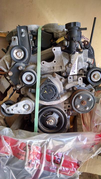

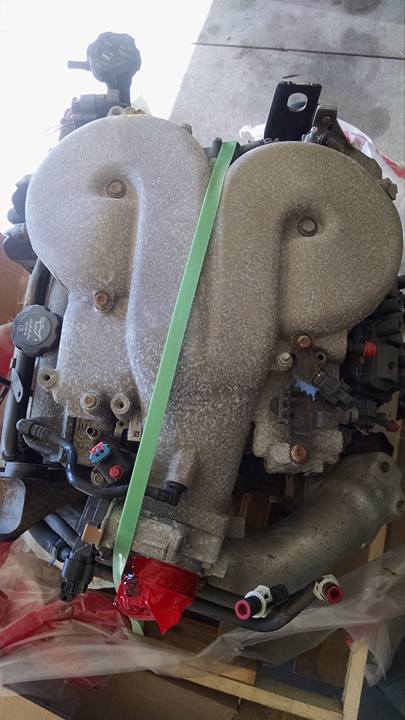

            Well, it's here.
            Look for a new build thread, dropping this in the Grand National.
