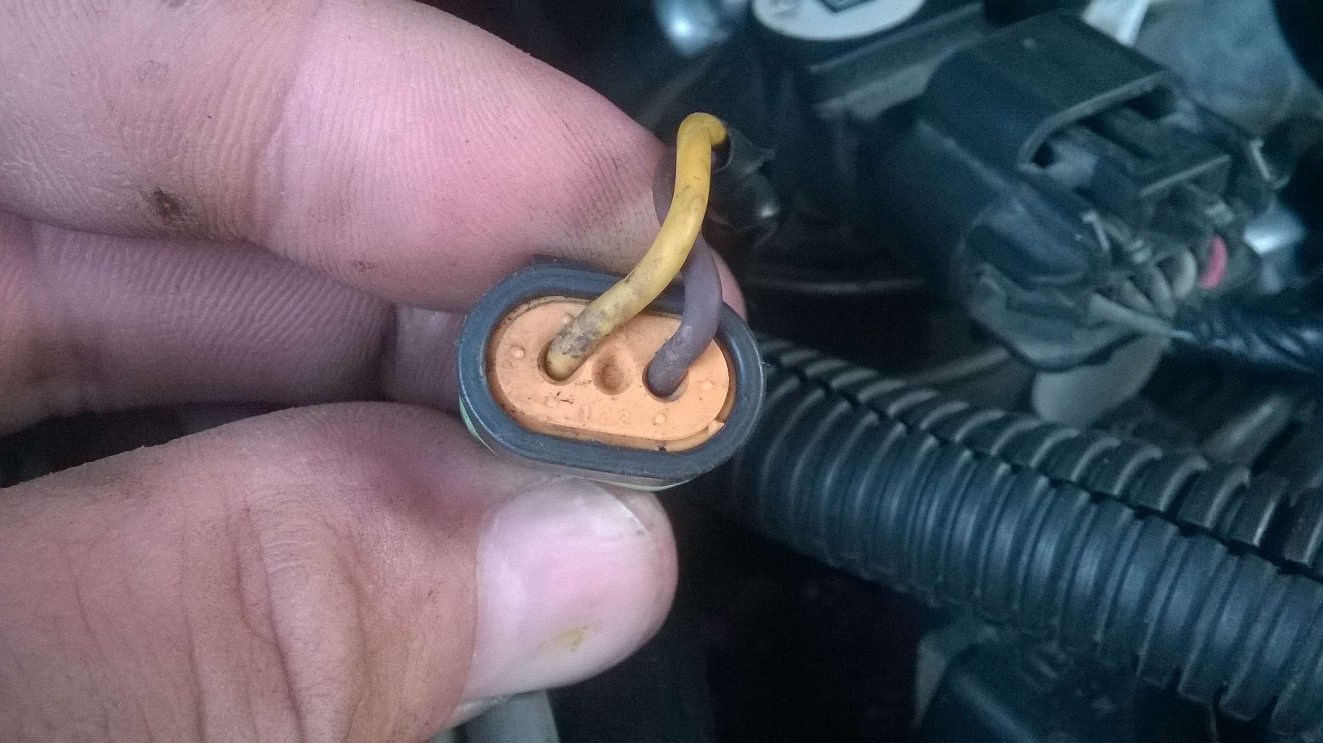

    I was wondering about that, I do have some of the metal insulation on it to
    • #47
      You will find that that one wire will be wrapped in a foil insulation and not be in a pinout on one end of the plug. That's how the L bodies area at least.
      • #48
        This one just had 2 wires, blown\yellow with what was left of the wire loom. When I get home ill twist and put my shield back on

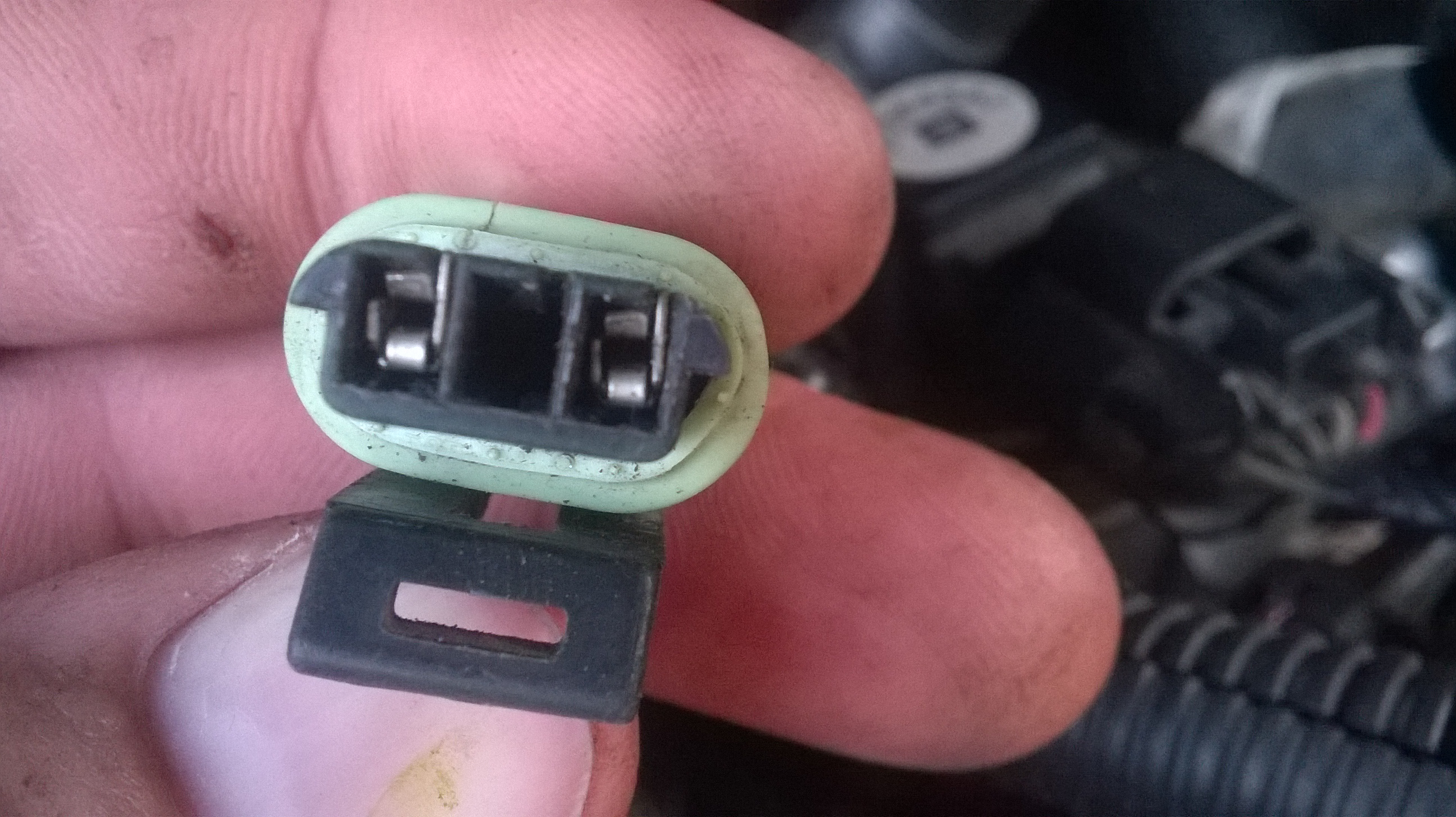

                  There are 3 conductors, in EVERY vehicle that uses this ICM and coils. Two of the wires, purple and yellow are attached to both the crank position sensor, and the ICM, the third, is a shield connected to only the ICM. Make sure this shield is ONLY connected to the ICM, having it grounded or touching metal parts at any other point negates the ability for the shield to reject noise.
                  • #54
                    I've come across tons of cars that only use two wires on the harness, with no shield wire present.
                    '86 Fiero, 3500, 4-speed
                    • #55
                      No third wire, mine old 3.1 didn't have one either
                      • #56
                        That's very odd. I have not seen that before and every text I have looked at that deals with this module indicates that there is a shield that is connected to the module.
                        Every vehicle I've looked at would confirm my previous statement too.

                          I remember seeing it in my DOHC documentation as well, but I never recall seeing it on one of my engines.
                                Every 3100 in a beretta that I've worked on lacked the shielding wire... the 3.1MPFI in my 90 on the other hand has it.
