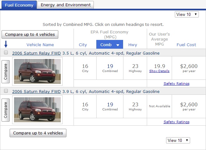

Originally posted by carbon View PostThe problem is that the nut behind the wheel of this particular van is a certain female and when I ask why the average fuel economy always goes up when I drive it, she just looks away... Regardless, the thing is still a pig. The last U-vans had so much frontal area, it is a hopeless case for aero on the freeway too.
Mine is more awesome with alloy wheels and roof rack spars...
Originally posted by carbon View PostHowever, diesel is at $4.20 a gallon where I'm at and gas is $3.49 so that kinda throws a wrench in it.
Originally posted by b1jetmech View PostHow about a 3900 swap in that???
