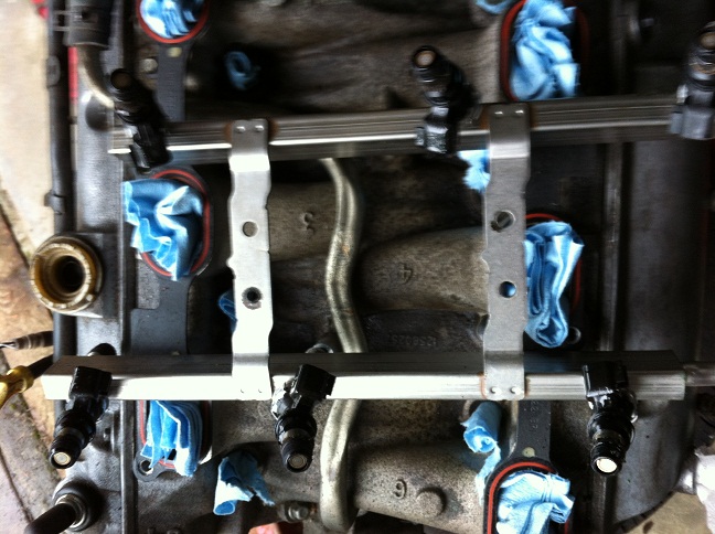

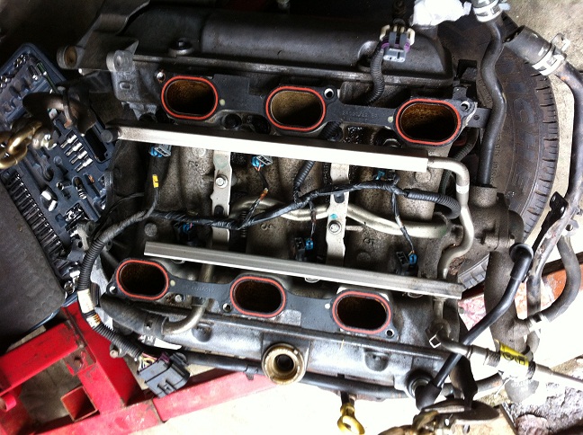

I just recently picked up my second LX9. It and my current one are both 06s out of G6s and as I'm taking the new one apart I'm finding differences. Both have the 7484 forged crank.

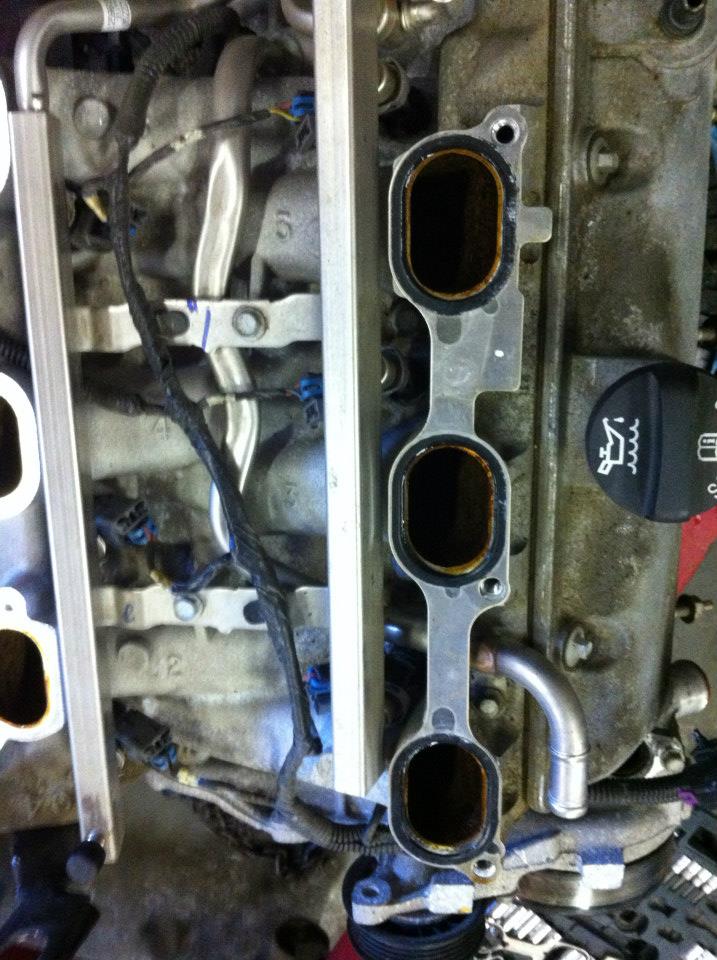

It looks like the paper/plastic UIM gaskets were replaced by metal gaskets:

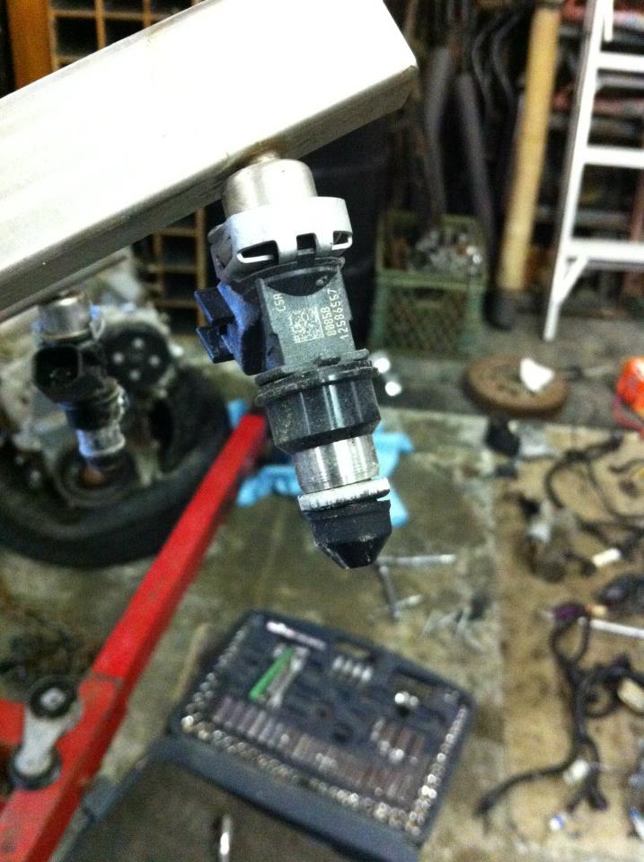

The fuel injectors also appear different:
(note that ones from latest engine have a more tapered tip)
I also noticed that the UIM is missing a vacuum port at the accessory end of the engine that is there on the one in my Fiero.
Just wondering what's with the differences in the same year. Are the metal UIM gaskets an upgrade? I haven't removed the LIM yet but am going to sometime soon.

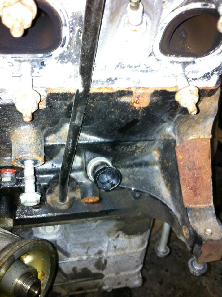

Oh and a question:
It looks like this is a oil pressure sensor:
Is it for a gauge or for a switch? When I swapped one into my Fiero I reused the stock sender in the location next to the oil filter.
