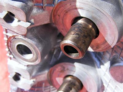

    I picked up the heads from the shop and asked the owner " Where are the bronze guides you told me where uncommon to see as in never before seen by your shop of 40 years. He showed me and i took some pics of what he pointed to. My magnet stuck to them like glue. Is bronze magnetic?...Was i wearing my " I'll believe anything" t-shirt today?........Tom

      Bronze is not magnetic.
      • #18
        Those guides look like steel. Bronze is golden in color,,, a little darker than brass..
        Also X2 on the "bronze is not magnetic...
        Hope this helps,,
        Tom...
        • #19
          They may look bronze in colour but it is most likely oil staining. All the aluminum heads used iron guides.
