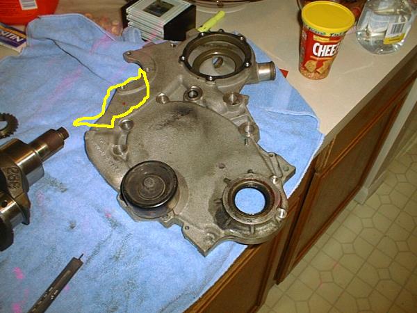

                  • #24
                    If one were to try to cut the yellow section out...
                    Would leave some meat for an idler pulley to turn the water pump, AND allow the thermostat housing to be there...

                      • #26
                        no go on the FWD timing cover.. right where the LIM T stat neck would be is a coolant passage. You would have to cut through that, weld both sides shut and run a hose around..
