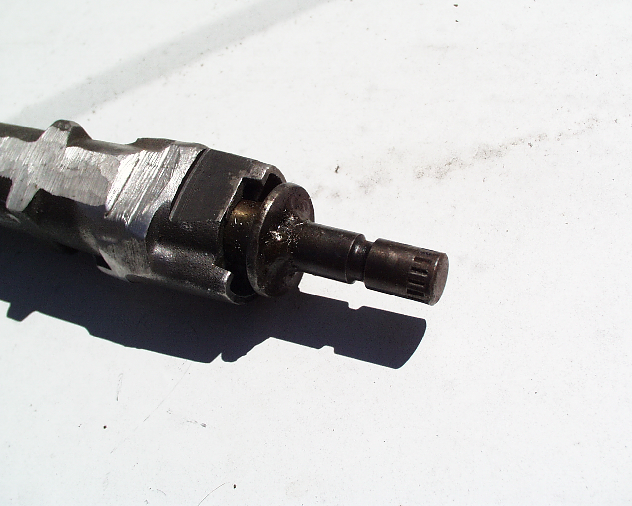

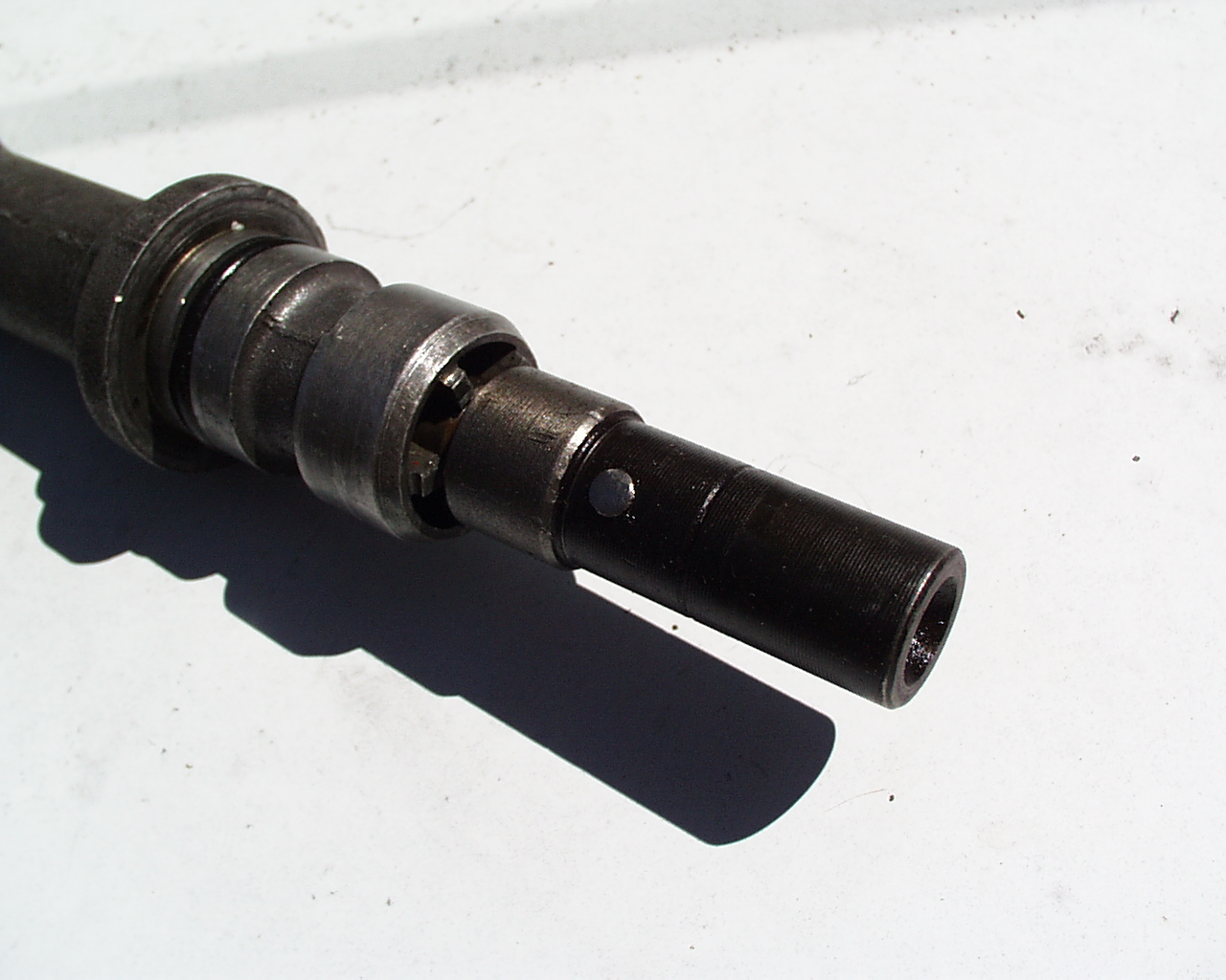

Remove the upper plate, rotor mounting flanges, any centrifical weights/plates, etc. Once everything is removed, the shaft will fit in a 1/2" drill chuck. Next is the hard part - the lower gear. I had the gear from the distributor "de-toothed" on a lathe, but the same could be accomplished with a grinder or belt sander.
In the attached pics, the relief channel in the distributor housing marked with a "D" casting (below the O-ring) is the lifter galley channel for the 1-3-5 cylinder lifters. Without the housing in place, a huge hole is left open at the back of the galley, and the rear lifter set won't get proper pressure.
A washer was welded to the upper shaft to aid in installing and removal of the unit during the prime.
