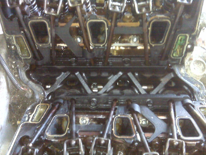

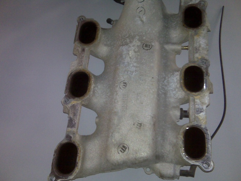

    Where are the stampings on the heads and intake to verify what I have
    The only stamping I see on the upper intake says 24508235 I think???
    post a pic of the ports... we'll know what you have...
      My 3400 intake in front me of is 24508236 so I woud say thats right. The lower will have 00 on 2 corners.
        Here are a couple pics
          definitely large port upper, the small port has a more oval shaped port
