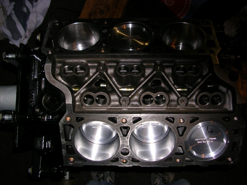

                I can't explain what happened with you, but here is picture proof, 1 and 4...

                  Ah, i had it backwards...#1 is right front not left front of the engine. That was confusing but it is cleared up now. I am not familiar with 3100 engine, i apologize.

                    Rule of thumb for any GM engine, the furthest forward cylinder is #1, in our case that would be the back cylinder on the passenger side for a FWD V6, a V8 it's on the opposite side.
