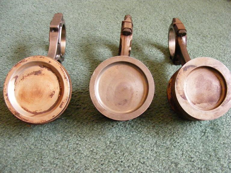

        EDIT - OK here are a few pics of the pistons I have.
        From left to right we have 3500, 3100, and 2.8 pistons. If you look closely there are arrows on the pistons pointing towards the front of the engine (pulley side).

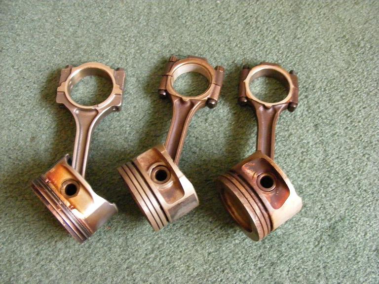

        Here is the transmission side of the rods. Notice the little half round tabs in the middle of the rod just above the bearing on the 2.8 and 3100 rods. Also the 3500 rod has tabs on either side that extend to the edges of the rod.

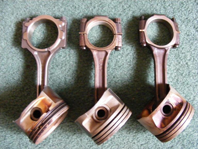

        And here is the side facing the pulleys. Notice no tabs on the 2.8 and 3100. Also the 3500 rod has tabs that don't go all the way to the edge like trans side does.
        And finally the bearing caps. we have the 2.8 and 3100 starting from the left with a beveled edge towards the pulleys. The 3500 has no distinguishing marks on the outside of the cap. It has interlocking grooves that differ from one side to the other to make it easier to identify which way the cap goes on.

        My engine with the original rotating assembly is in a crate under a pile of other engines/parts so I can't dig that up at the moment. I have seen this question asked before and I figured it would be a good idea to get some pics up with an explanation of the orientation of the rods. If any of the senior members can confirm or deny this, or have something to add, that would be great!
