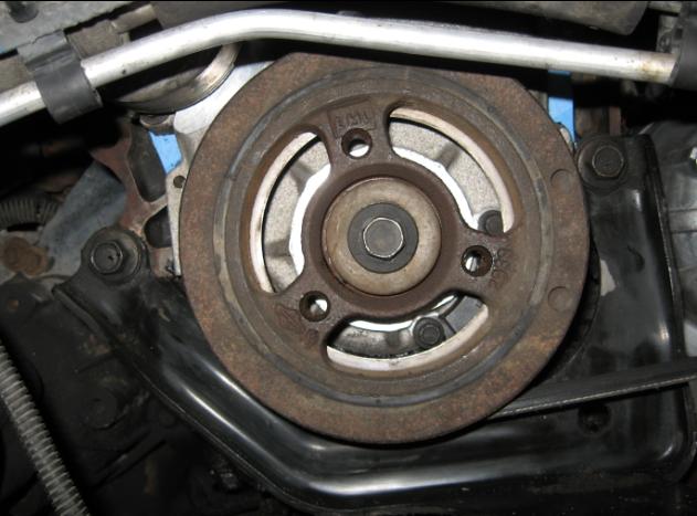

                      what the hell is this rubber ring you speak of. every crank pulley from a stock engine hasnt had one. the only thing it has it the metal ring you transfer over.

                        The rubber ring is embedded inside the damper. You can see it if you look. I'll try to find a picture.
                          Rubber between the 2 pieces.
                            oh ok never really looked at that side.
                            ok if thats there for a reason on the stock one then why when they made the ud pulleys didnt they incorporate it into them.
